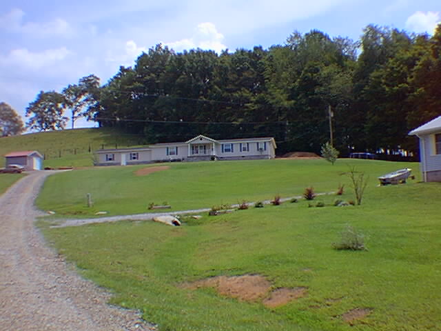

howdy crabjoe
after reading your post I thought I would go give my CK20hst a shot in high range up the drive way. I didnt have a bit of trouble and it would accelerate the more I pushed the pedal. I all I have on mine is the FEL rear grader blade and the tires are loaded. Attached is a pic of my driveway.
