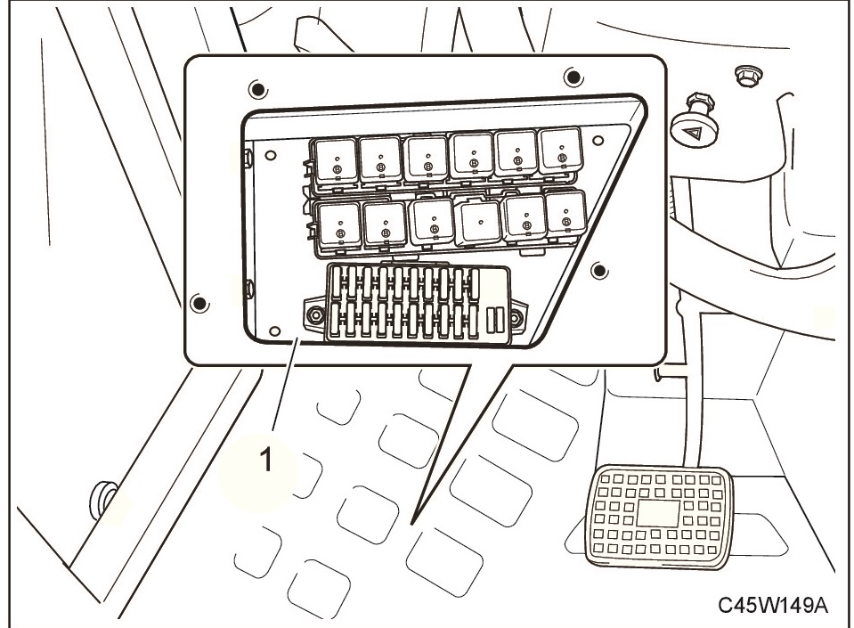

Sure thing. But that's where the entire fuse panel is on my DK45S, and presumably other DKs. I do keep the tractor under cover and there is a rubber mat covering the "floor", so maybe it will continue to be OK. Is that where the fuses are on the SE models?
the fuse panel is up under the dash on the right side. The main fuse is inline near the starter.
   / CK20HST, no power, NOTHING, no dash, no lights, no start, #$@%^&C*!@!!!!!!!!! #8
Really?! Your fuse panel is under your floorboards? I'd like to see pics of that setup. Both my prior DK-35se/hst and my current DK-40se/hst have all fuses in a covered box on the lower right of the steering column. I don't doubt what you're saying- I do find it near impossible to comprehend why anyone would put fuses in that location....

Really?! Your fuse panel is under your floorboards? I'd like to see pics of that setup. ...
I din't have an actual photo handy, but here's a fugure from the manual:
