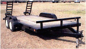

I had borrowed one of my brother's 6.5-16' before and wasn't satisfied with the length for carrying the mower, loader and extra implements.
A few days ago, I purchased a 7' X 18' so I could carry several things at the same time. The fit is great and the Suburban hardly knows it's back there. I bought a proportional type brake controller that supposedly keeps the brake working with the braking of the truck. It works good and doesn't cost a whole lot. I didn't want to take time for the installation so I paid to have it done.
The trailer is actually considered light equipment. Two 3500# axles, brakes on both. With a 1/2 ton I wouldn't go with just one brake. The trailer is made with Channel, not angle iron. $1975 + FL 7% tax. Brake controller and installation $225.
Also bought 4 US chains 3/8 Grade 70 chains and ratchet binders. Chains and binders about $250.00
The attachment is a picture of a similar trailer. Mine also has a spare tire mount about mid way on the rail in front. John

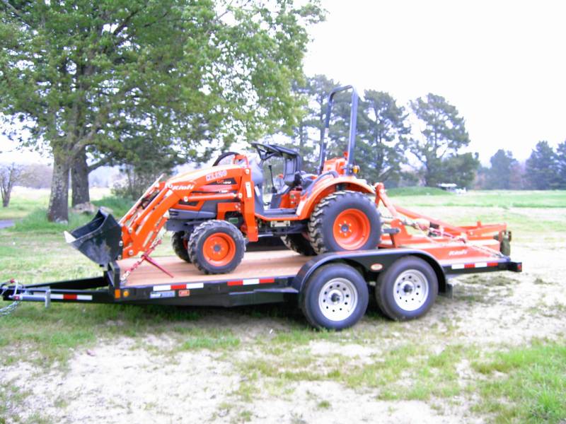

I haul my CK20ST w/loaded R4's on an Iron Eagle 7x14 7000# trailer w/removable ramps, 5x2 steel tube frame, brakes on both axles, breakaway sytem, 2x6 pressure treated deck. The trailer weighs 1,590# and only needs 10% weight on tongue.
The CK20 fits and rides nicely on it, but with the 52" mower on I have to "fudge" it a little as you see in the pic, but still rides good. I pull all this with a Ram 1500 5.9 short bed and Tekonsha Prodigy brake controller. In the pic it looks like the rear of the truck is "squatting" but what isn't seen is the front is sitting on a rise, it rides nearly level. In 20/20 hind-sight, I should have got the 16' but only had a "guesstament" of what the total length of CK20 would need, so with all this said, the shortest you should go is a 16 if you have loader.
Norm
CK20ST; 52" mower; 48" box; 49" tiller and more to come
