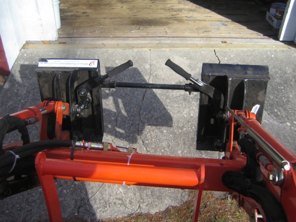

I'm still considering a CK20, and forgot to ask the dealer the other day when I was there about a QA for the loader. Is there something available from Kioti, or do you have to find an aftermarket solution....... if so, what are you guys using? I am interested in having forks, and possibly a grapple at some point.

He is looking for a Quick Attach loader which is basically a plate with locking handles that mounts on the end of the loader arms and it makes changing between different buckets, forks, etc... very quick and easy. What Kioti means by "quick-detached" is that the entire loader, arms and all can easily come off the tractor when not in use.
I beleive a QA setup is aftermarket only on the CK20.

There are several companies that make aftermarket pin mount to QA adapters for the Kioti CK line (I believe the KL120 and KL130 share the same pin mount dimensions). As noted above, ATI makes one but it is pricy (?$600 or so). Horst Welding in Ontario makes one (I had that model on my CK20, tough but heavier than the ATI or others). Millonzi now makes one I understand. Rick Wallace has somebody who makes a QA adapter for his dealership. Don't know that much about it but if Rick chose it it is likely very good.
I've now got a Kioti standard issue QA adapter on my DK40se. It is considerably lighter weight/construction than the Horst but seems certainlly strong enough. You don't want too much weight tied up in a QA adapter as it comes right off your lift capacity. I don't believe Kioti makes a QA adapter that fits the CK line.

I haven't seen all of the options but I'd think the extra distance extended from the pins is pretty close. Add about 2inches for the thickness of the actual attachment plate and then a few more inches for the pin mount. I think they are all likely to be within an inch or so. Where they do differ is in how heavily they are built. I know the Horst is heavier (135lbs) than the ATI or the Kioti DK standard QA but I don't know about some of the other options.
/ CK20 QA? #13
I just checked the QA that is on my CK30, it is a Horst Welding unit. Model number is: BOQF10KIKL120, capacity- 3500lbs. It looks to be the same one that Steve_Miller showed in his post. My guess in the model number that KI says that it is for a Kioti, the KL120 says it is for a KL120 loader. So I am guessing that the pins on the KL120 and KL130 loader are in the same place.
