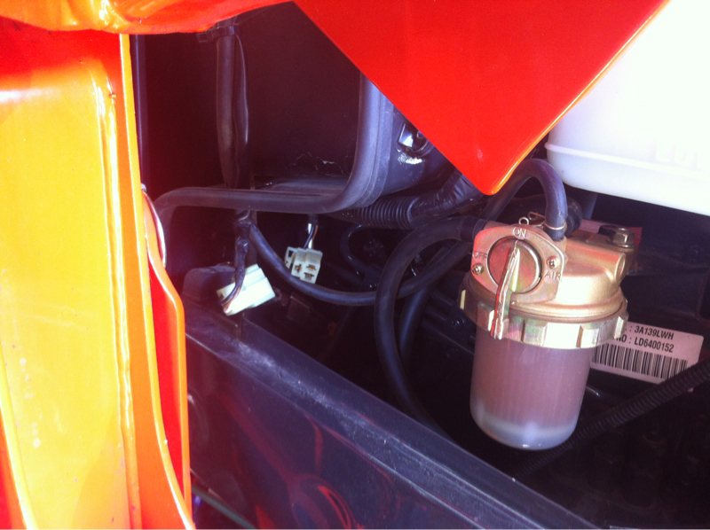

#33
This is a connector that goes to the head lights.
I am getting 3 volts across one terminal when the switch is on low beams. Nothing when switch is on high beams.

/ Ck weird electrical. #35
Chris where do you reckon that connector is in relation to the combination switch and the relays? in other words, is that connector in the middle ? With the combination switch on one side and going out to the relays on the other?.. if so, I would suspect the combination switch.. How much trouble would it be to pull the combination switch out and inspect it for water and its connector ?. 3 volts of course is not right it should be 12 volts coming from the combination switch terminals going to the coils of the relays to energize them. So something is sure wrong with the 3 volt reading. You would normally measure with your voltmeter negative lead on a good clean ground and poke around with your positive red lead to take readings by the way. I would go directly to lets say the low beam relay coil and take a reading with the combination switch on low, and the key turned on and see if there is any voltage on the "high" side of the coil. the other side of the coil should be grounded to the chassis ground. If no voltage there, I would work backwards thru whatever connectors until I made it back to the combination switch. OR you could start at the combination switch. and measure for input voltage and out put voltages to ensure the switch is good. I wish I was there to help you.
