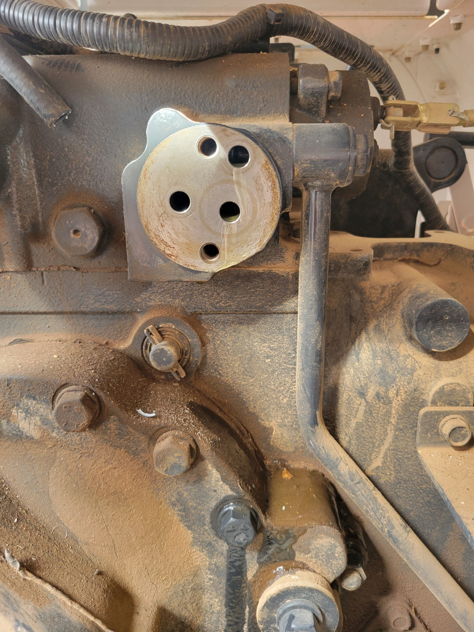

hello,
Thank you for this informative bit. any chance you took pictures during install?
I have a 2009 bobcat ct230 same as a kioti ck30 tractor looking to add this kit if it will work. No one seems to know.
Thank you in advance
larry j.

you want the previous generation ck remote valve, notice the porting is compatable with your pic,

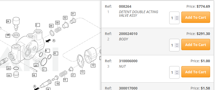

Does anyone know if this "previous generation" remote valve for the CK is still available anywhere?
they are rare but occasionally the odd NOS one comes up, you may not be able to be fussy if you want detent or not,

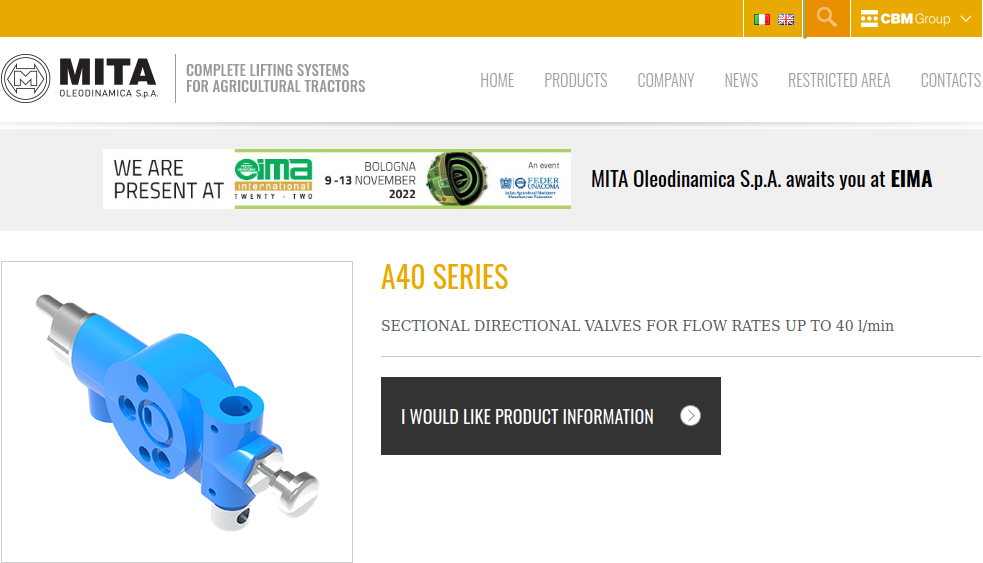

the following is an NX series valve and the porting looks the same however i wouldnt be surprised if you could make it work. but no guarantees of course. the main issue is the outlets come out the opposite side of the body and fitting could be troublesome.
