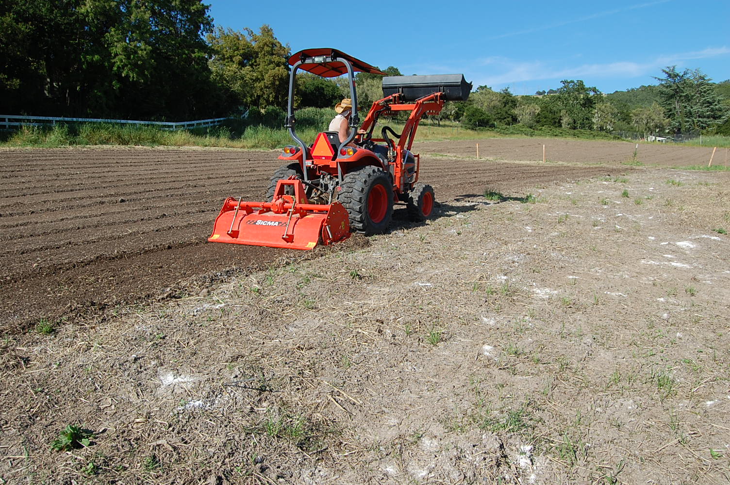

Both my tillers are 66" and cover my R4 wheel tracks on my CK30.
