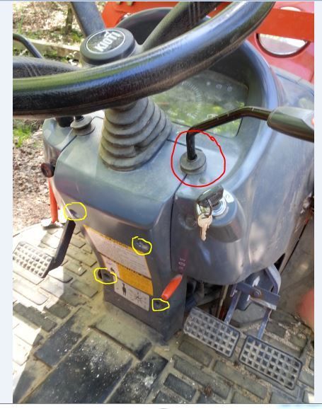

Was using my CK30 around the house, get back on the tractor one time, pushed the Gas Lever and nothing. Obviously is disconnected from the feed wire. I was able to use the foot pedal. Did some observation and found where the lever wire and foot pedal wire meet. Pushed foot pedal to see which one was lever. Follow it back up, it is a green covered wire heading into the dash.
But now to fix it. I see the possibility of removed a part of the dash, with four ??screws?? at the yellow circles. Some were filled with dirt dauber gunk, and I cannot see into them to determine what is needed to remove. Anyone have some experience or suggestions with this? Thanks in advance

Those four bolts do indeed take the front panel off the dash. I have done that, though I was working on the other side for electricity. The throttle cable is the green one, same on my tractor. You may need to pull the rest of the dash, but those bolt are hidden away, don't remember where. The front panel is a good start there.
The gas lever is called the throttle, confused me when I saw the title as I thought you meant the fuel cut-off valve on the sediment bowl.

Thanks. I guess is would be tough for a diesel tractor to have a "gas lever". Sorry about the multiple posts above. TBN was giving me fits yesterday.

Took a little bit of maneuvering but four 10mm bolts got the middle section out, and eight more released the major portion of the dash so I could see the throttle connection. Green wire was broken, and looks like repair is out of the question.
What is best method to obtain a new throttle wire?

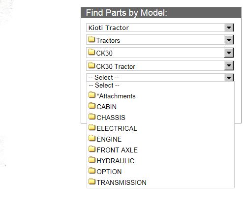

Local dealer or Michigan Iron has a pretty good web site that you can order from.
