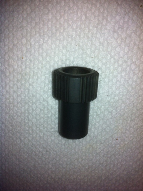

He said in his second post he bought the gears at his local injection shop.
Maybe he can give us some more info on that.
In his second photo you can see (near left edge) the broken teeth on the old gear. Also (in both photos) you can see how it is possible to rotate the gear 180 degrees and the rectangular flange on the plunger will go right back into the gear (hence the basis of the 180 degree fix). AFAIK, there are no reports of broken teeth on the rack, only on the gears. Given the OP was able to buy new gears, he was smart to just replace them in case the original gears came from the same bad batch (just a theory). Since Kioti has stonewalled this issue, I, like you, am interested in a local repair option at a small fraction of the $1-2K Kioti fix (i.e. factory new IP). My 2006 DK came from the era of IP failures so this interests me.

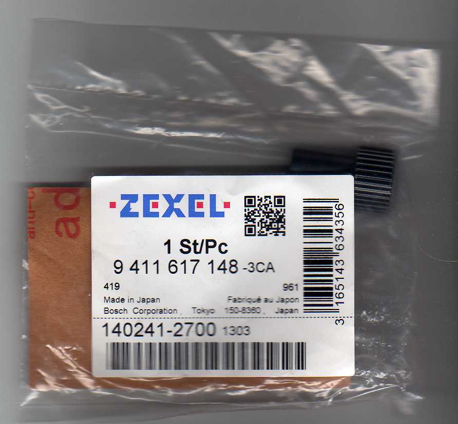

Where did you purchase the gears. Do you have a partnumber for these gears? Fixed mine by rotating the gears but would like to have some in case it happens again.

Just so everyone knows. These gears are available from Conestoga Diesel under part number 9 411 617 148. Current price $25.75 each plus shipping. I ended up paying a total of $92.25 for 3 to be shipped to Texas. They also repair the pump. A standard rebuild with new gears is often right around $300.

P.S. Although available from different sources in Europe and Japan (and maybe here in US) Conestoga Diesel have been great to work with and it's hard to beat their delivery time.

Bernty,
Excellent information. Many thanks. I added a link to your post in my spreadsheet, which has a link in the "sticky" pose at the top of this Kioti O-O forum.
By the way, do you know which Kioti models use this specific part number? It's possible that all 3 and 4 cylinder Tier 3 IPs use the same gear, or maybe not. As I recall, Conestoga needed to examine ERE's CK25 IP to determine the correct gear. I don't think Diesel shops here have any tech data (parts cross reference) for the Doowan part number.

A follow up on my CK25 HST injection pump failure. With some guidance from ritcheyvs and a local injection pump repair shop I decided to remove the pump myself. It was easier than I thought. The shop I took the pump too was familiar with the brand and had gears in stock. Two days later I picked the pump up and they verified one gear had two broken teeth. They replaced them with stronger gears. Cost of the complete repair with labor and tax was $116 . While I was at the shop I asked if they do mail order repairs and they are happy to repair and ship anywhere. A plug for the shop.
Spokane Diesel Pump Repair
628 E Pacific Ave.
Spokane, WA. 99202
(509) 838-3556
The gears that were in the IP before rebuild cannot be turned 180 and reused because of an area on the back side of the gear that does not have machined teeth. The area is approximately the width of 2-3 teeth, at the same height as the surrounding teeth. I've included a picture of the back side of one gear. All three gears were like this.
Everything went back together smoothly and the tractor is up and running again.
