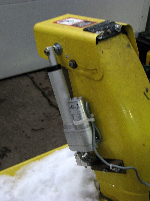

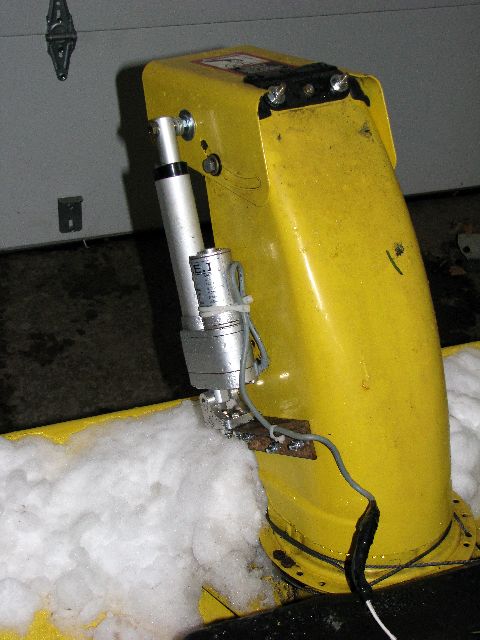

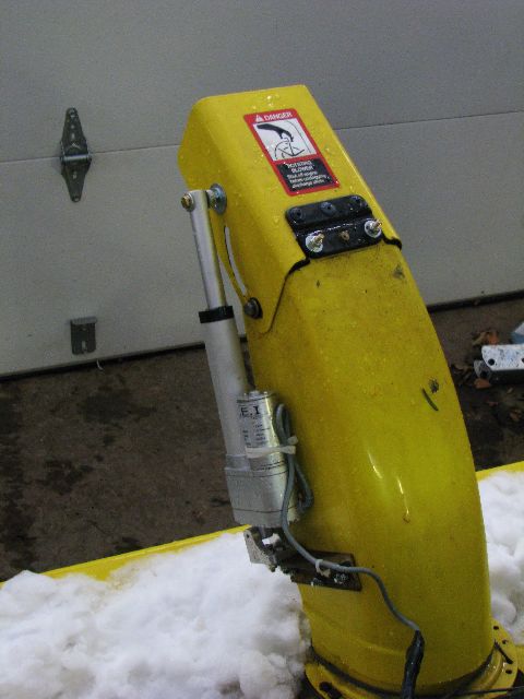

I got tired of getting off and on the tractor to change the deflector on the snow blower chute. The rotation is hydraulically controlled.
I added a 12 volt linear actuator to control the chute deflector. The control switch is in the cab. Works great.

Nice!! Did you build your own chute rotator?? Pics please??
   / Chute deflector operator for snow blower #3
Looks good! I put a hydraulic chute deflector on my blower, but the electric option was similar to your setup. Sure is nice not to have to keep getting out of the seat to adjust, isn't it? :)
   / Chute deflector operator for snow blower #4
That's great! Can you post a link and/or the specs for the actuator you used?

I used the following for the linear actuator.
Bottom mounting Bracket is part number
Burden Sales Surplus Center Item Detail
Actuator is part number
I used a short piece of 2" x 2" x 3/16" channel to mount the actuator bracket to the chute and a 1/4" x 3" bolt to hold the top.
You also need some bolts, wire, a DPDT center off momentary toggle switch and a fuse in the supply wire to the toggle switch is always good protection.
