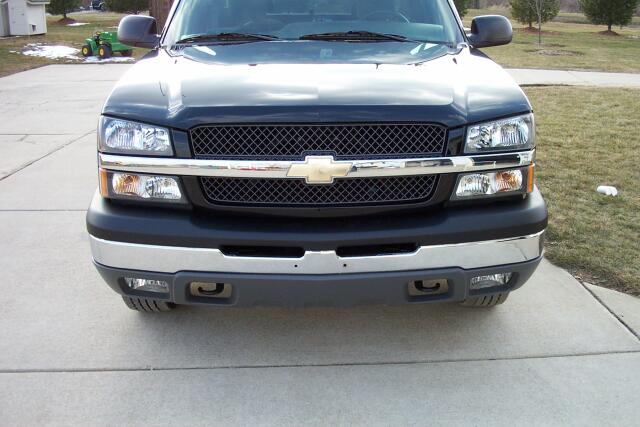

Many of you have seen my post about my New Truck , I am looking for a way to accomplish a little change I would like to make. I am not happy happy with the front end appearance of the truck and I would like to chrome plate the cowl around the grille. See the attached 'before' picture.

The next picture illustrates the look I am interested in. I bought some adhesive chrome tape and did a mock-up of what I'd like it to look like.

The cowl pieces are made of plastic and are painted the same color as the body (black). I would like to remove these parts and take them to a shop to be chromed. Does anyone know if this is feasable. How much would it cost? Am I crazy? /forums/images/graemlins/confused.gif (the wife thinks so)
