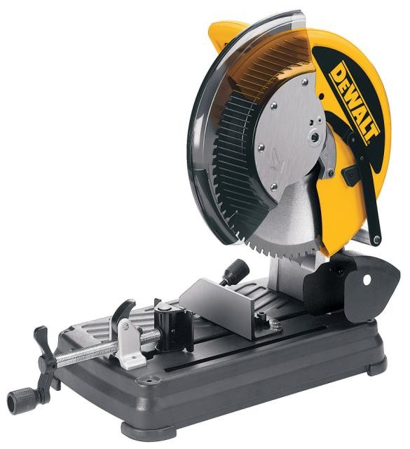

My 14 in Dewalt carbide cold cut saw runs about 1800 rpm. The abrasive chop saws run at about 3600 rpm. Rules are rules. I would not recommend running those blades faster than stated on your saw. Those carbide teeth imbedded under your skin probably hurts like he**.
I lost one carbide tooth, don't know where it went.
Use a magnet to help catch the metal chips.
Ear protectors are recommend also.
