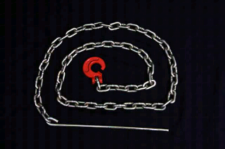

Dave,
I have the some of the same chokers as the one in the pic, I welded a piece of 3/8 rod on the last link and gave it a slight bend to help it slide under logs better. A straight one will dig into the ground.
I actually like my chokers with a Gr 70 ring in the end better, I have had the split ones release when the load comes off, the ring ones don't.
Those are the chokers I use. I like the steel rod.

Dave,
I've never had a problem with them coming loose at all.
I do like the idea of a small bend in the rod. I think I will add that when I make rods for mine. Thanks!

So what is the "real" name for the red choker piece on the end of the chain? I'd like to get a couple of those to add to existing chain I have, but I can't seem to get the search terms right to find places that sell them!
   / Choker Chain Use #18
I believe it is a logging choker hook. Try Baileysonline.com Their good logging supplier. I've ordered from them before.. . .John
   / Choker Chain Use #19
I've heard them called Sweedish logging hooks, but cannot seem to get much traction with that as a search term. Baileys, Labonville, or Hud-son equipment might be good options to try.
