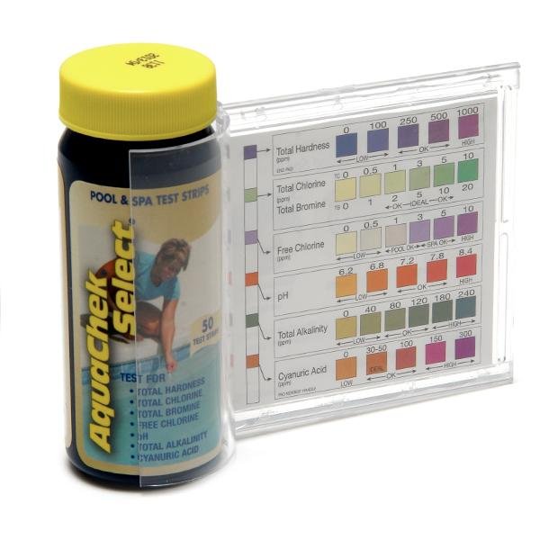

Lowe's also sells a test kit that has a stick with little pads on it and the one that I have will test for stabilizer level along with the usual free chlorine, pH, etc etc.

I will check Lowe's for strips. My pool supplier uses a test tube with a color chart. He thinks that's better than strips. I think strips would be great for a regular test.
IMO, he is right, the tubes are more accurate (that is what commercial pools/spas are required to use around here), but for personal use the strips are more convenient and easier to use.
