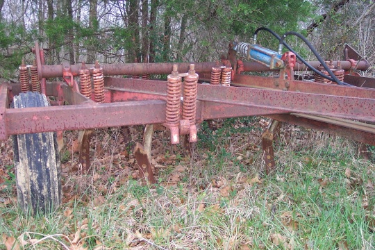

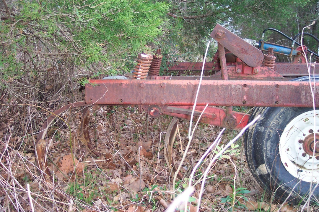

i have an old 9 shank chisel plow that i tried to pull with a 90hp kubota. i could control the depth with the wheels so i could tear up the ground 6-8 inches but that was all did better with two shanks removed but i was stillunder powered. ended up paying a real farmer to work it up with a heavy bog. 2 passes had former pasture land worked up nicely. i let i dry a couple days and lightly worked with disk and drag. i would like to find a small wheel bog that a 90hp utility tractor can handle.(don't know if there is such an item)
