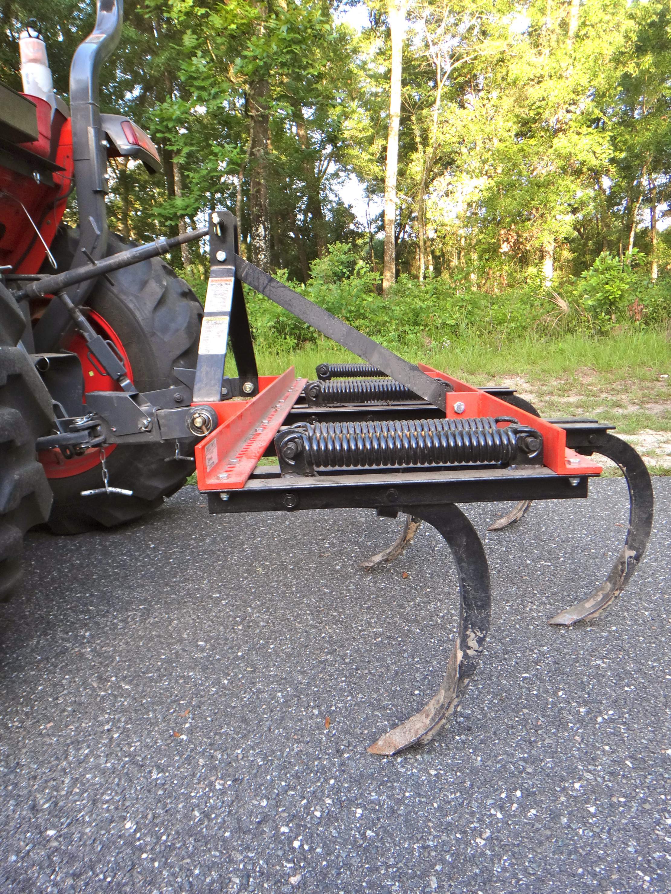

The implement in Post #7 is a nine tine Field Cultivator, not a Chisel plow. You cannot pull more than a five tine Field Cultivator with a JD4300 and that will be a load if you have 2-WD rather than 4-WD. However, unless corroded, the tines and springs are reasonably easy to move or remove. Then you will have spares.

Wow Jeff! Talk about overworking the soil! Most grass seeds prefer a firm seedbed - a bunch of deep tillage is overkill and will not help the situation. Cutting it a few inches deep with a disc a few times making sure it is level and smooth and then plant it. If you till it too deep you are not sure how level it is going to be when it packs back down.
May need to drag it is it is not level when you are done discing.
