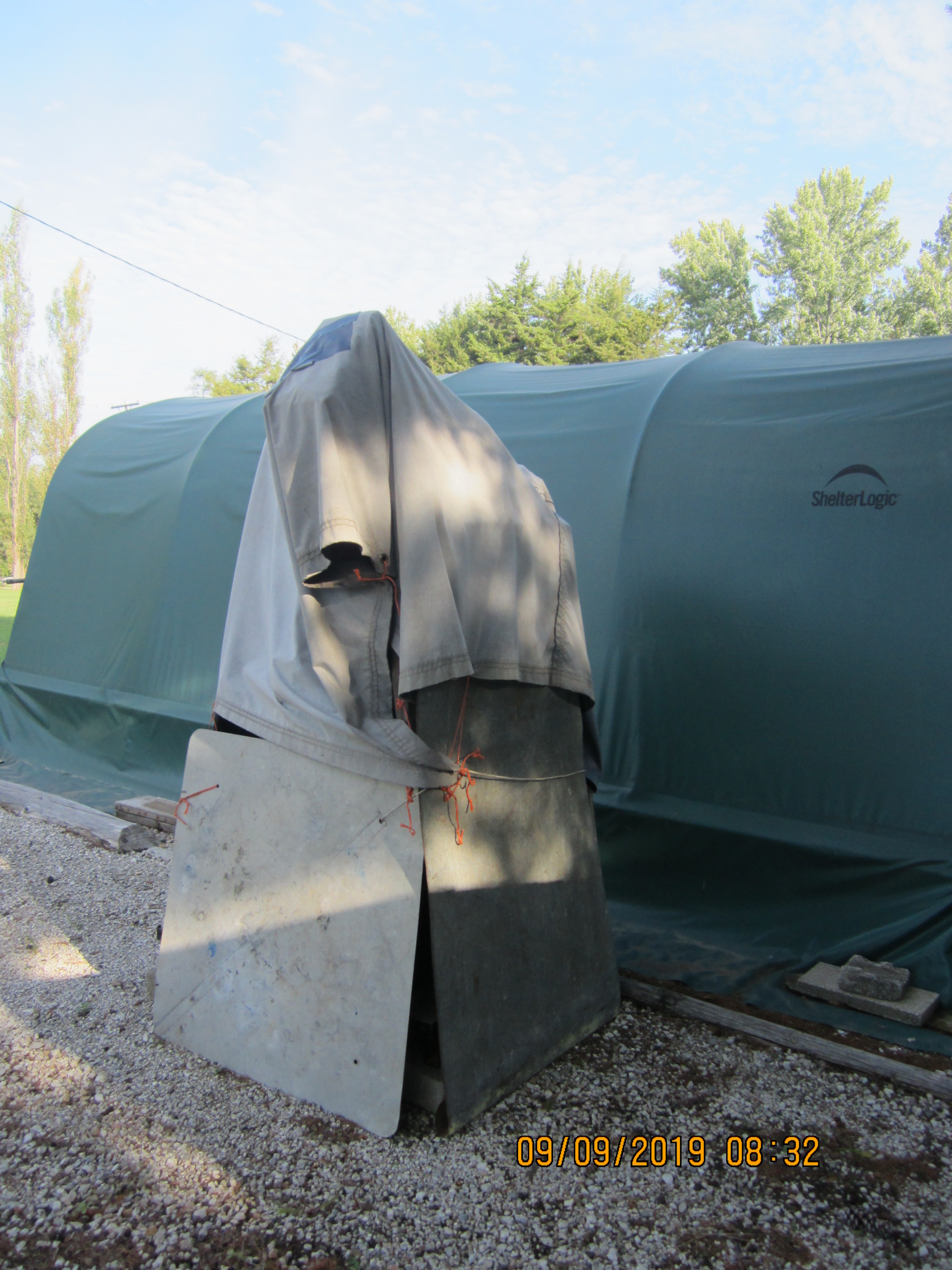

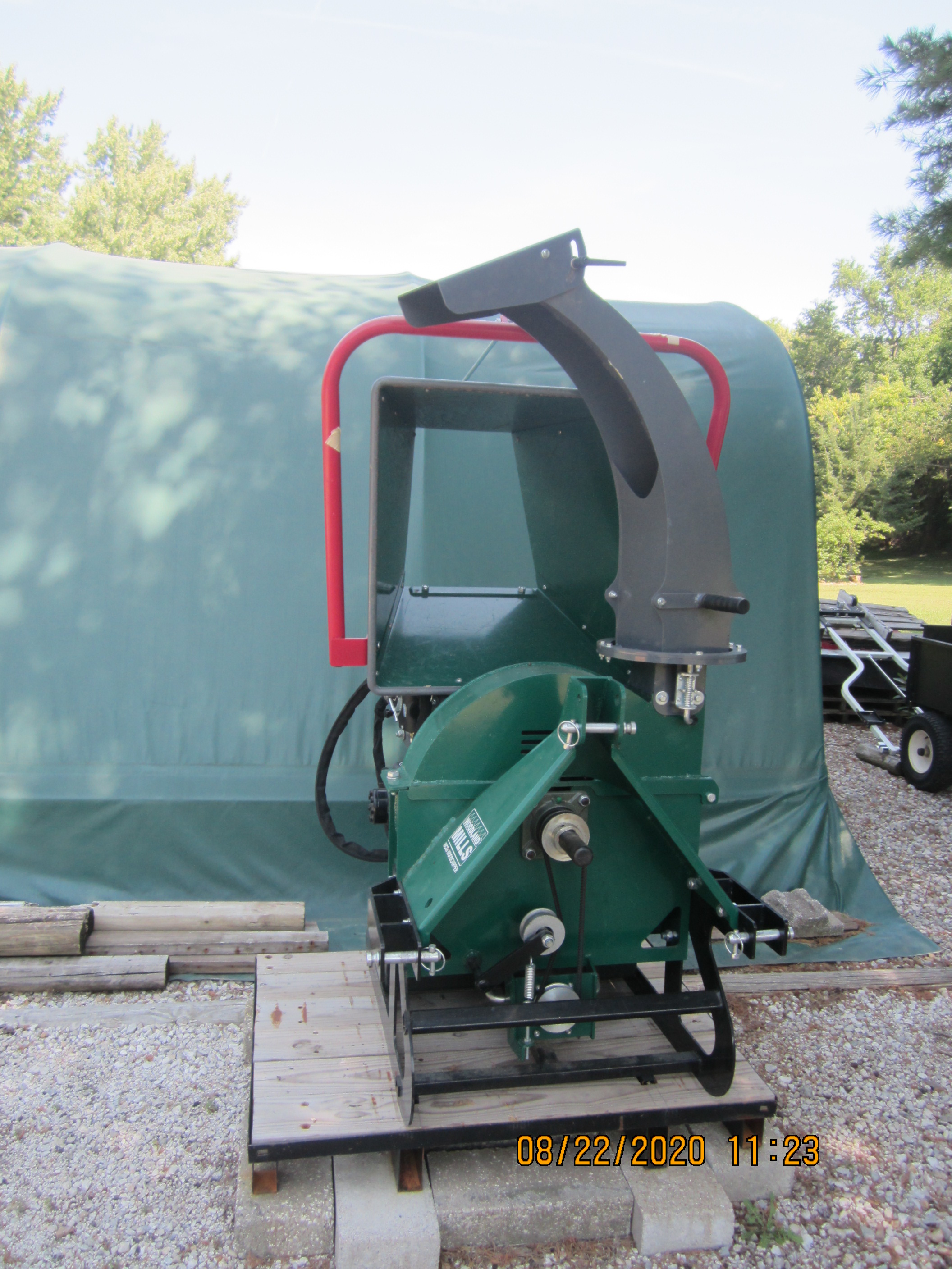

As others have noted........it is sitting up on the metal skid that it was shipped (IIRC), as well as some concrete blocks. The top is first covered with some old feed bags to slow the wear (sharp edges) on the tarp............and "Yep" the wasps and frogs like to find a home inside.
