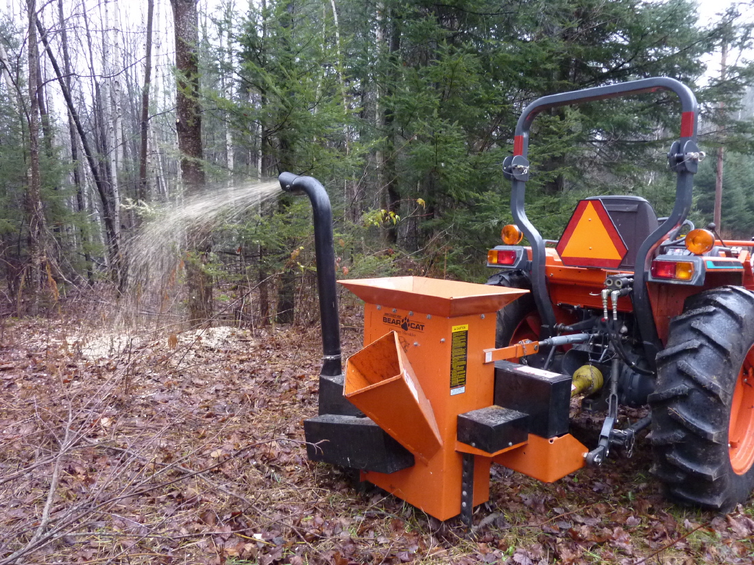

I lived with the chips blowing out on the ground for the first few months. I even spent that few months building my trailer dumping device just to deal with it. Even with that, it was still a pain getting them into the trailer, so then I built the blower. As many chips as I was making, I knew I would want more.
Between our combined pieces of property, I and my neighbors have quite a bit of woodlot. I get everyone's woodshed filled each year as a service project. This makes for lots of branches and brush to chip. At first I combined the chips with cow manure from a local farmer to make compost. The manure was so dirty and full of rocks that I stopped that and got given a fairly worn out sickle bar and started combining chips and fresh cut grass. That worked better anyway. Now we just top-dress with the chips.

/ Chipper Mods #34
My experience is the same as Roy's. I bought my BearCat used about 6 years ago and have never had any trouble with it.
It's to bad that you are having so many problems - doesn't make sense to me.

Maybe it's because it's color coordinated with your tractor.
You must have had to jump to get that pic with the chips still flying.
