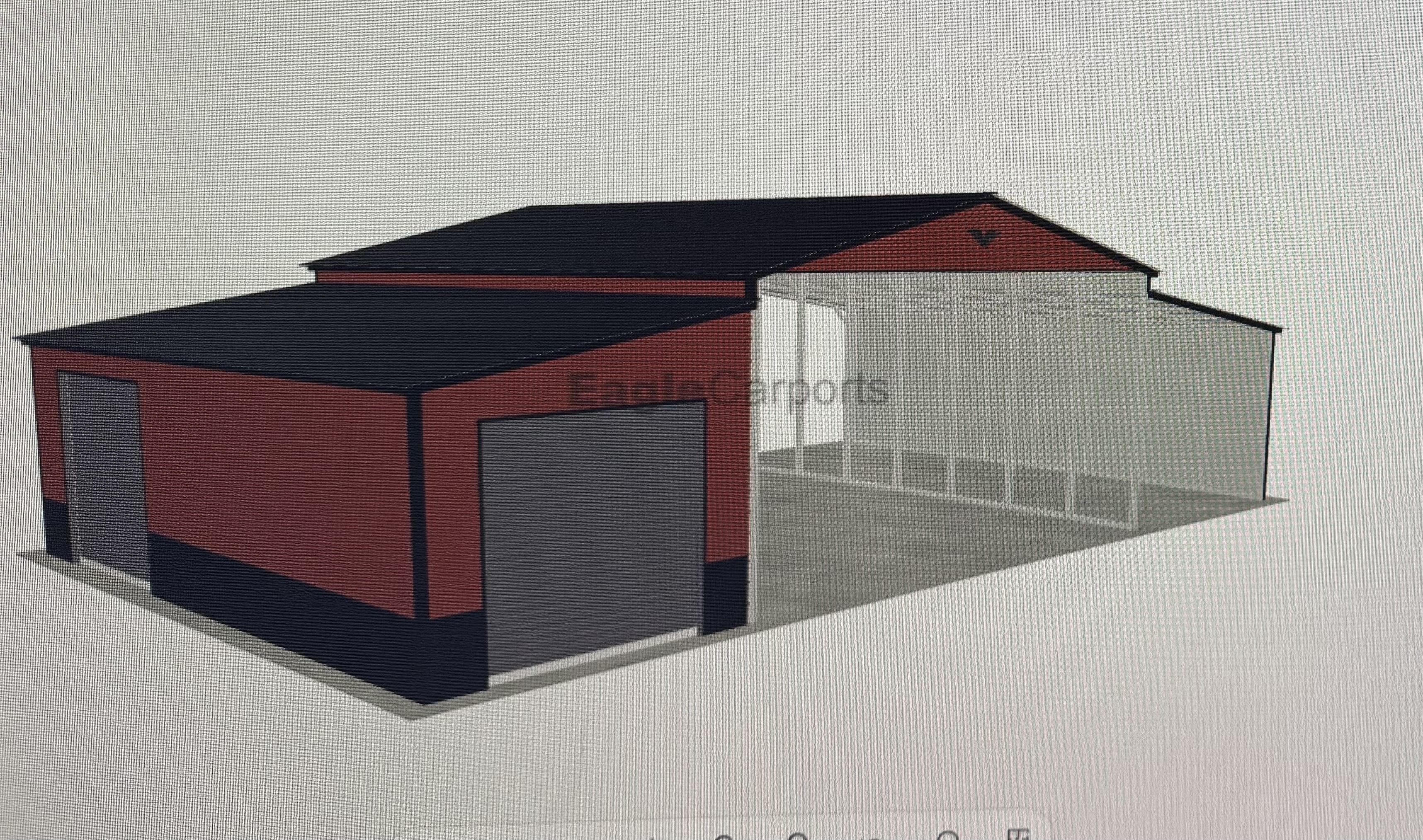

The XIX looks good too. I would prefer to have a bigger machine but we just bought a bigger camper and need a big carport. The idea is to build a big carport with a garage on the side and an additional lean to for the flat bed trailer. Not sure I can swing a bigger machine.
