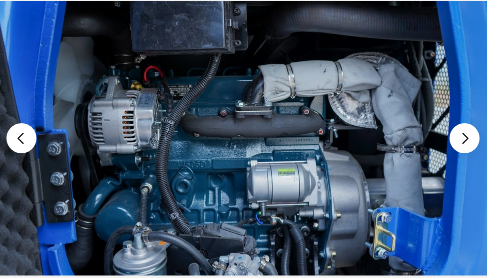

Just looking at it it has some nice features. I notice that the price is about $19k on Ebay for the cab model with Aircon. It does not list 2 speed travel but it does have faster travel of 3.4kmh versus my TT-17 at 2.1kmh. Hard to see how much space is in the cab for the operator but that it looks better from cursory glance.
Larger Kubota engine and near 6000lbs should make for more capable machine. I like how open the engine is from this image of the compartment.
