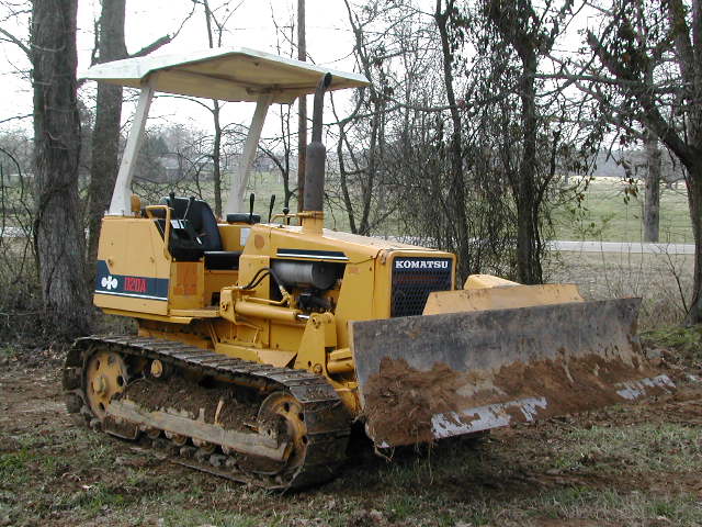

I bought a grey market Komatsu D20A about a week and half ago and it is great. It is 40 hp and weighs 9000 lbs. The D21 is sold in the US and the only difference is the 21 has a shuttle shift tranny and mine has a regular gear tranny. That really isn't an issue though because of the way the gears are layed out. I would not want anything smaller but it's small size is handy for getting in the tight spaces that I am working in. One like mine can be had for $10K to $13K. Attached is a picture.
