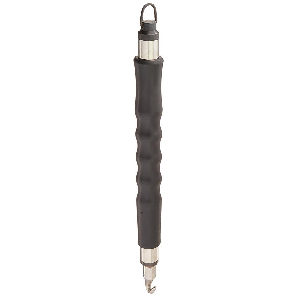

2x4 welded wire won't last long buried....rusts out. We used 16'x54" cattle panels, buried 8", with 6' 2x4 welded wire tied to them for height. Never had a 'dig under' issue, but climbing predators like raccoons will simply scale about anything and be right in. Only solution for them is lock up the flock at night.
BTW, rebar tie wire loops (we use galvanized ones) and this twist tool make tie wire to wire, or wire to T posts (get 10" ties) a snap.

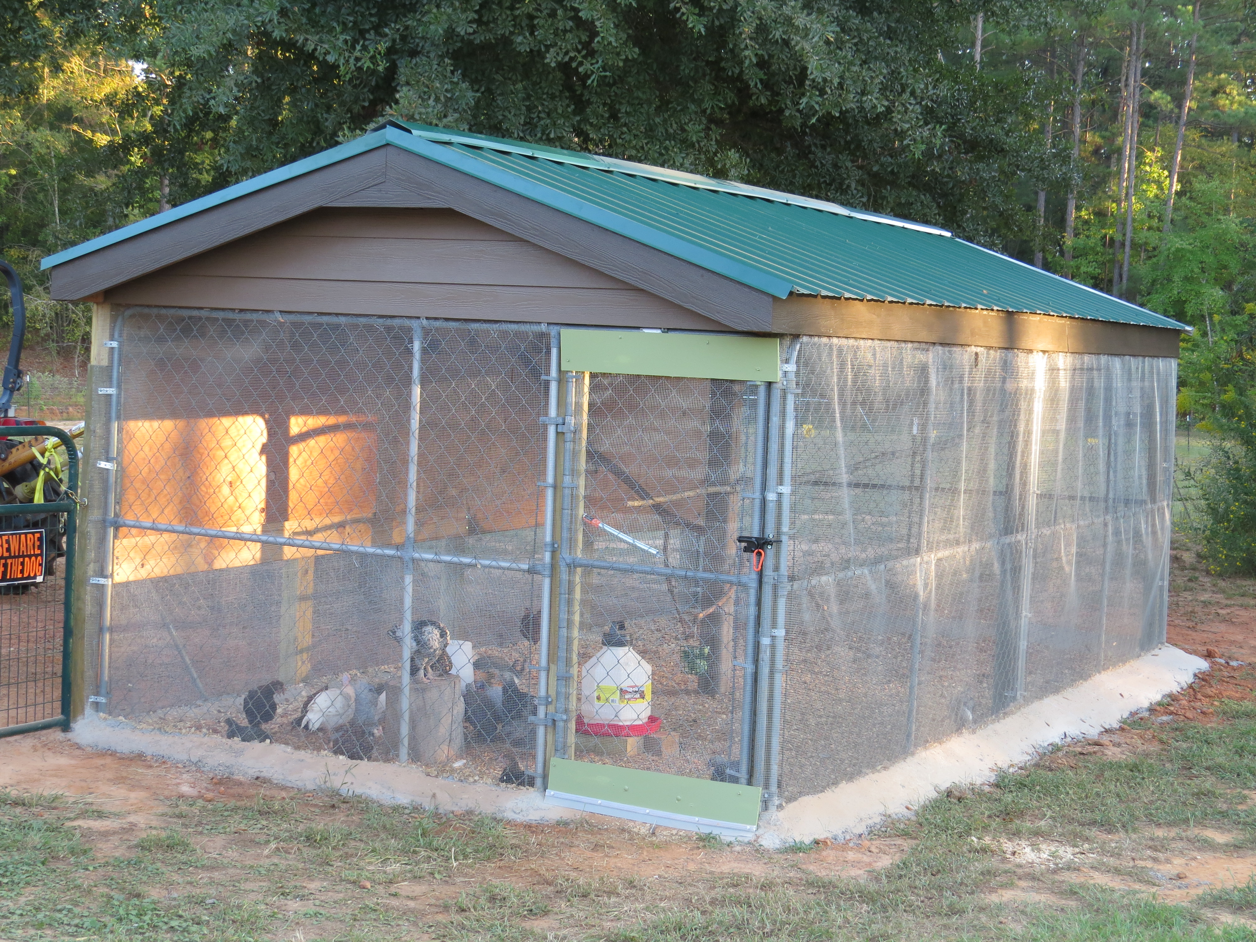

Around my coop I have quarter inch mesh so nothing can reach through it. At the base of my coop, we dug down with a shove and poured concrete so the mesh is in the concrete. 001 (2).JPG
