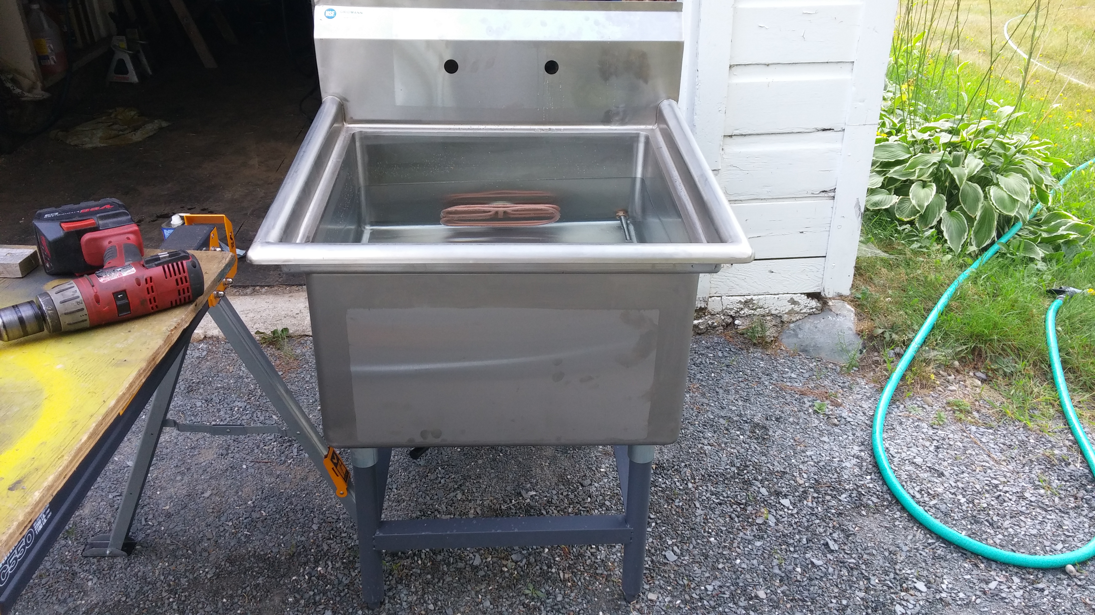

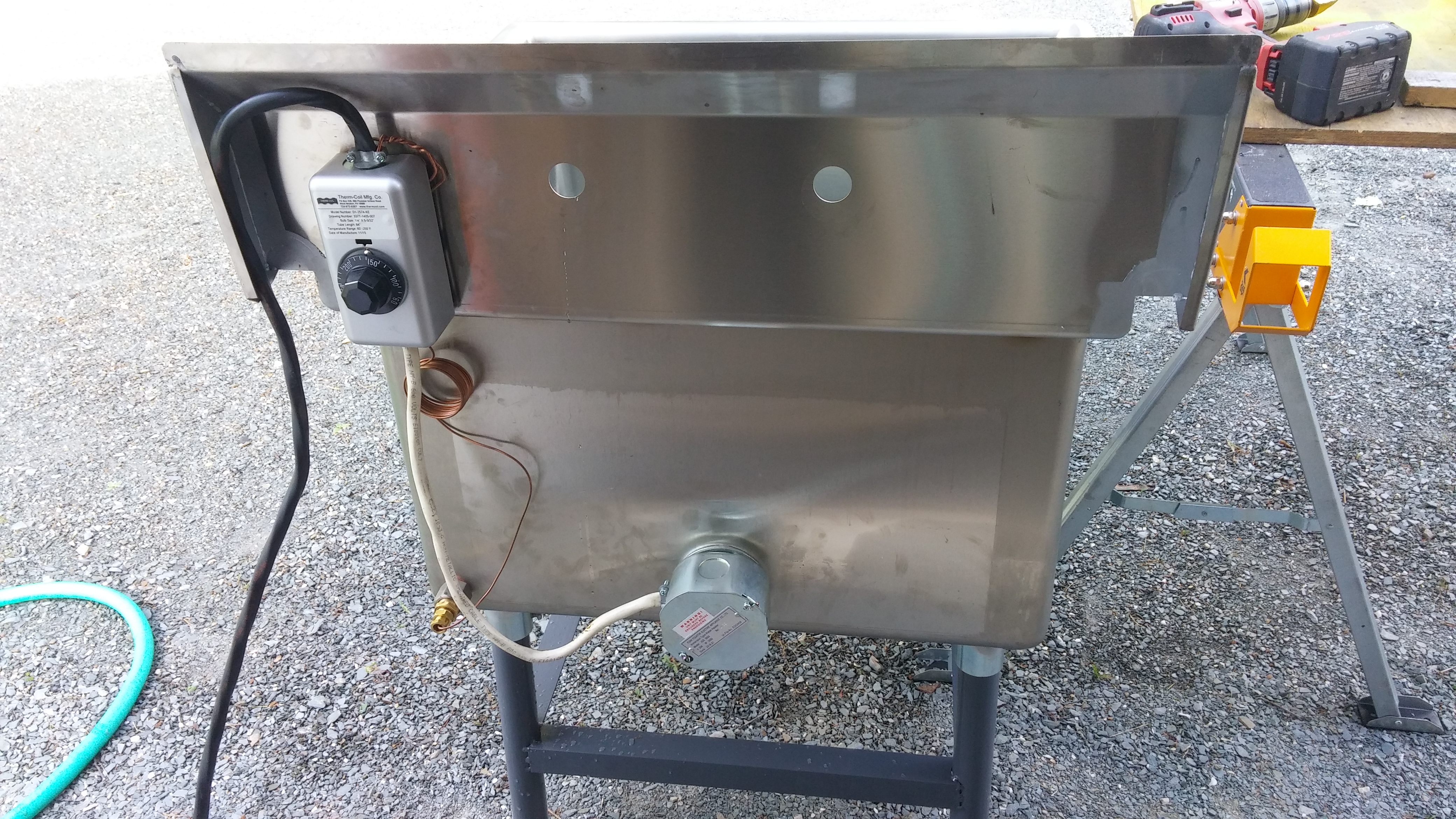

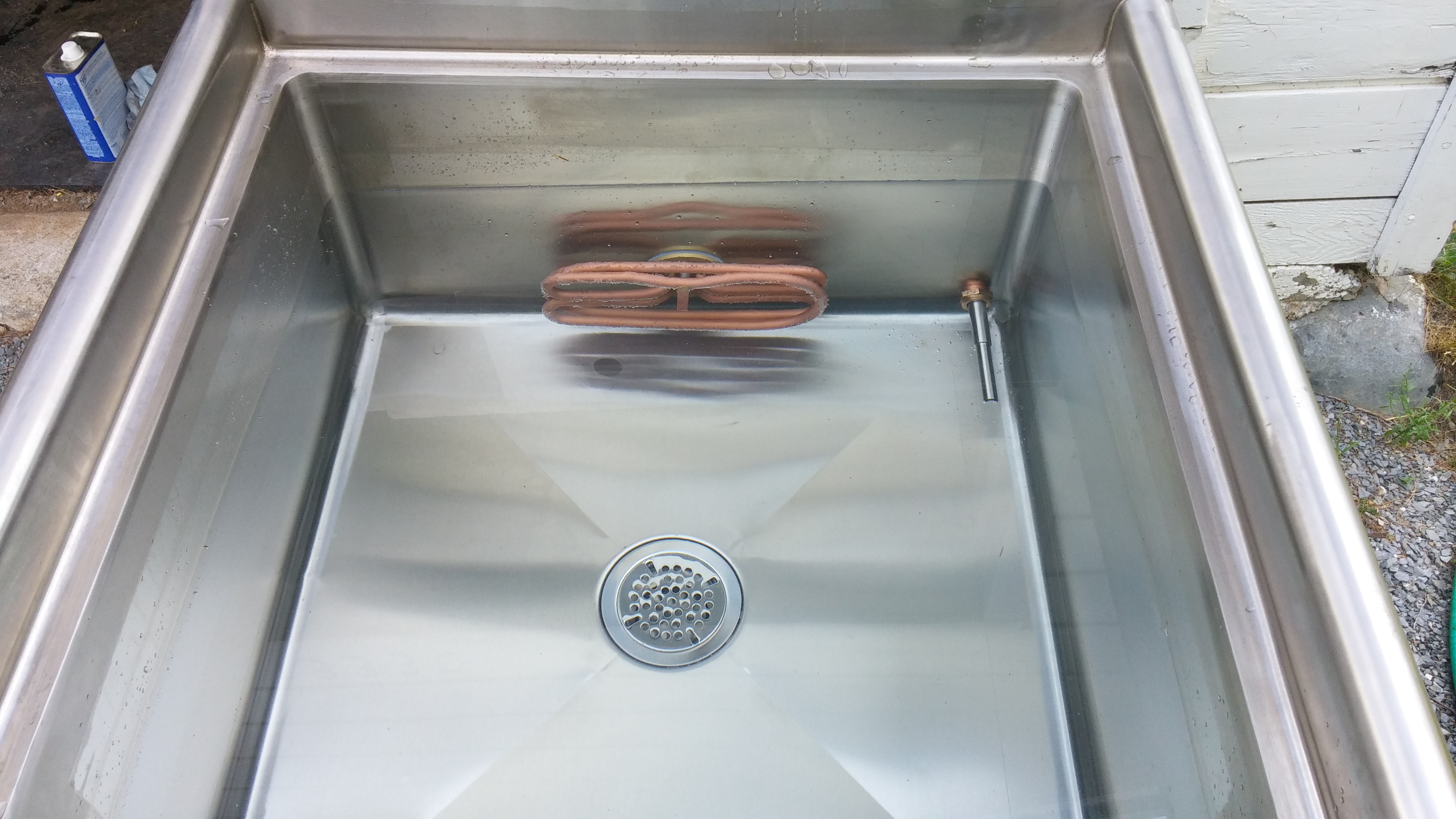

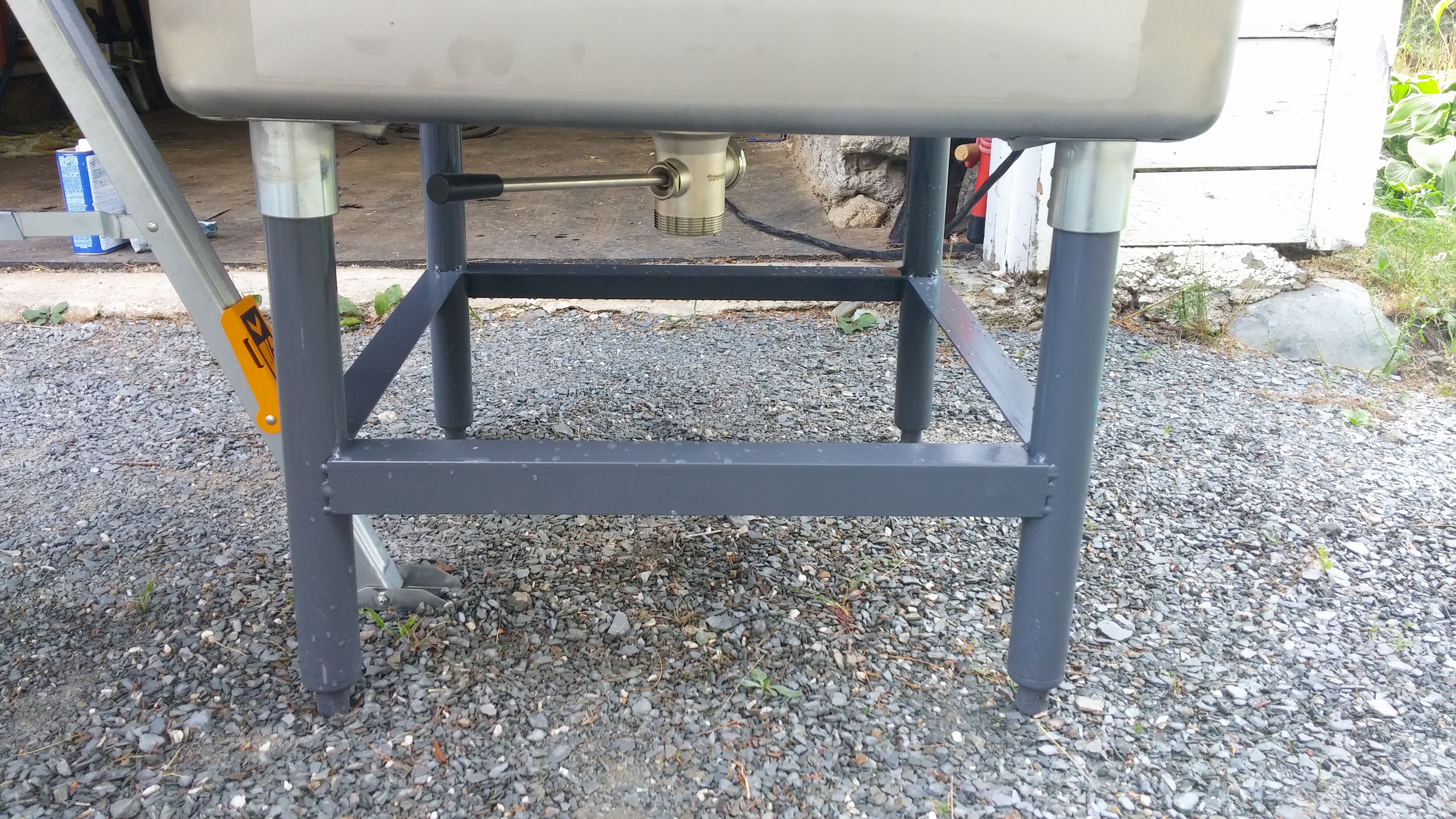

Just got my auto temp scalder built. Used a 5000w element from a steam table draws about 20a at 240v. Bought the sink on ebay and reinforced the legs. All in around $400 for all the parts bought the controller from mcmaster.
