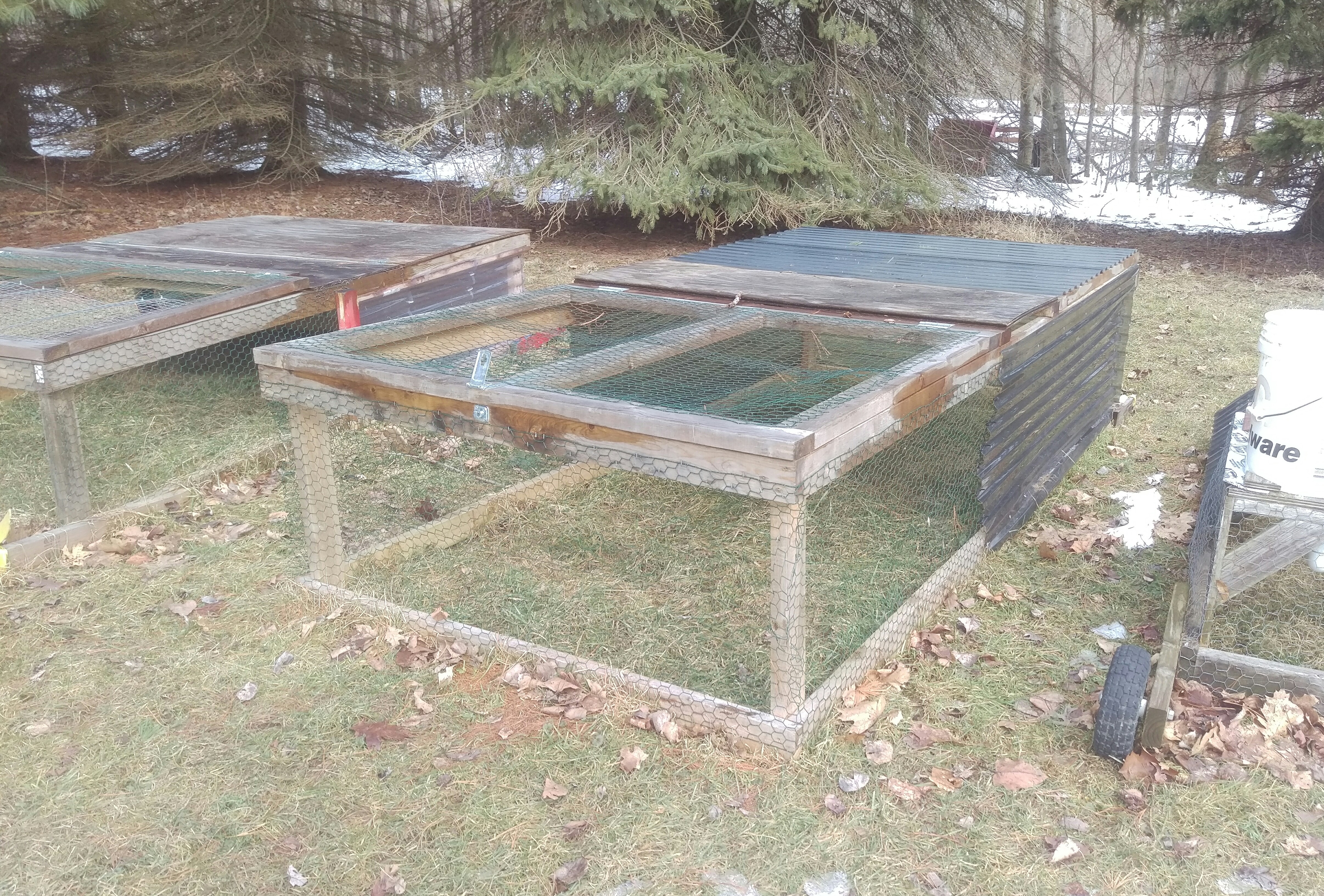

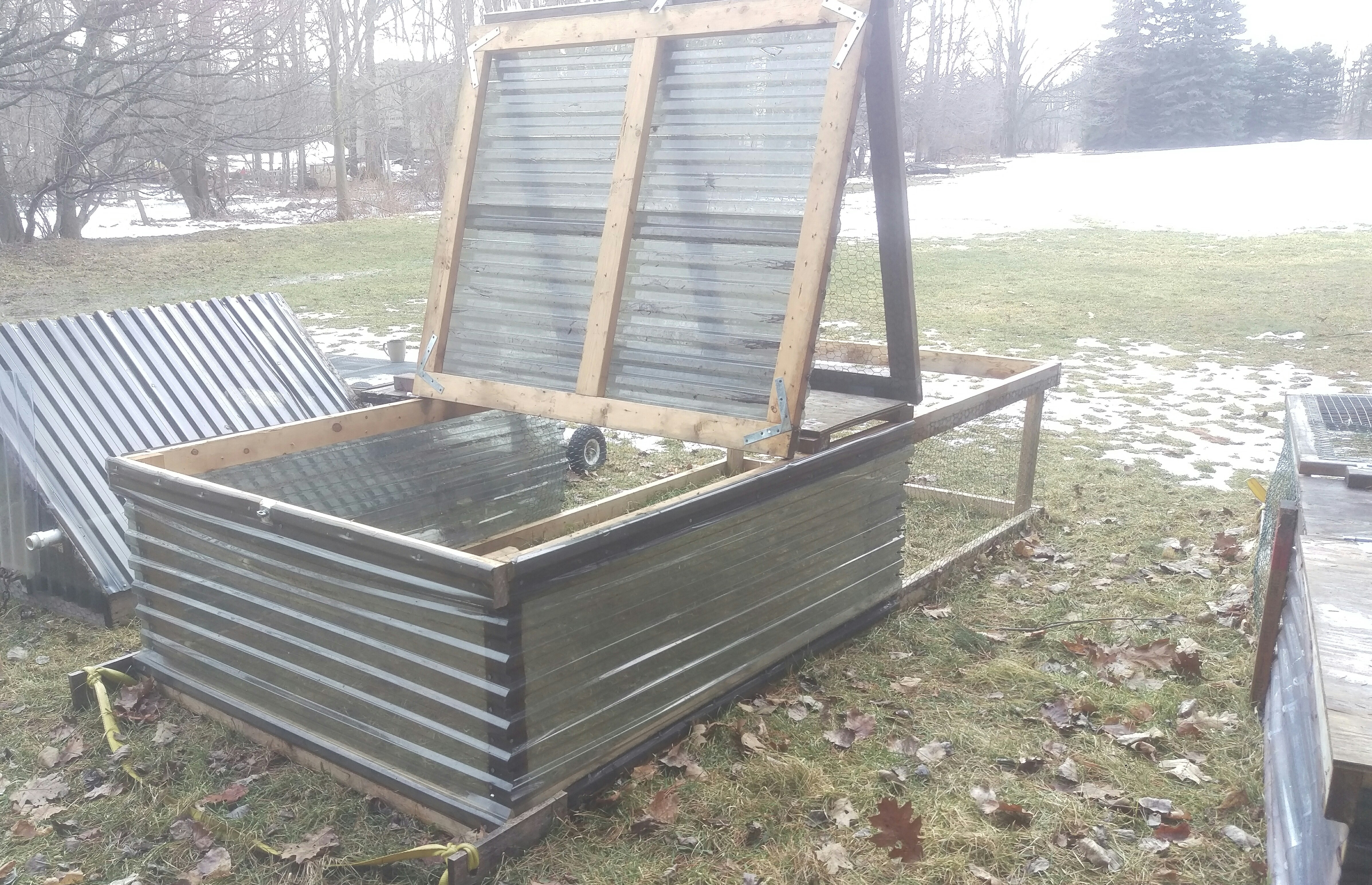

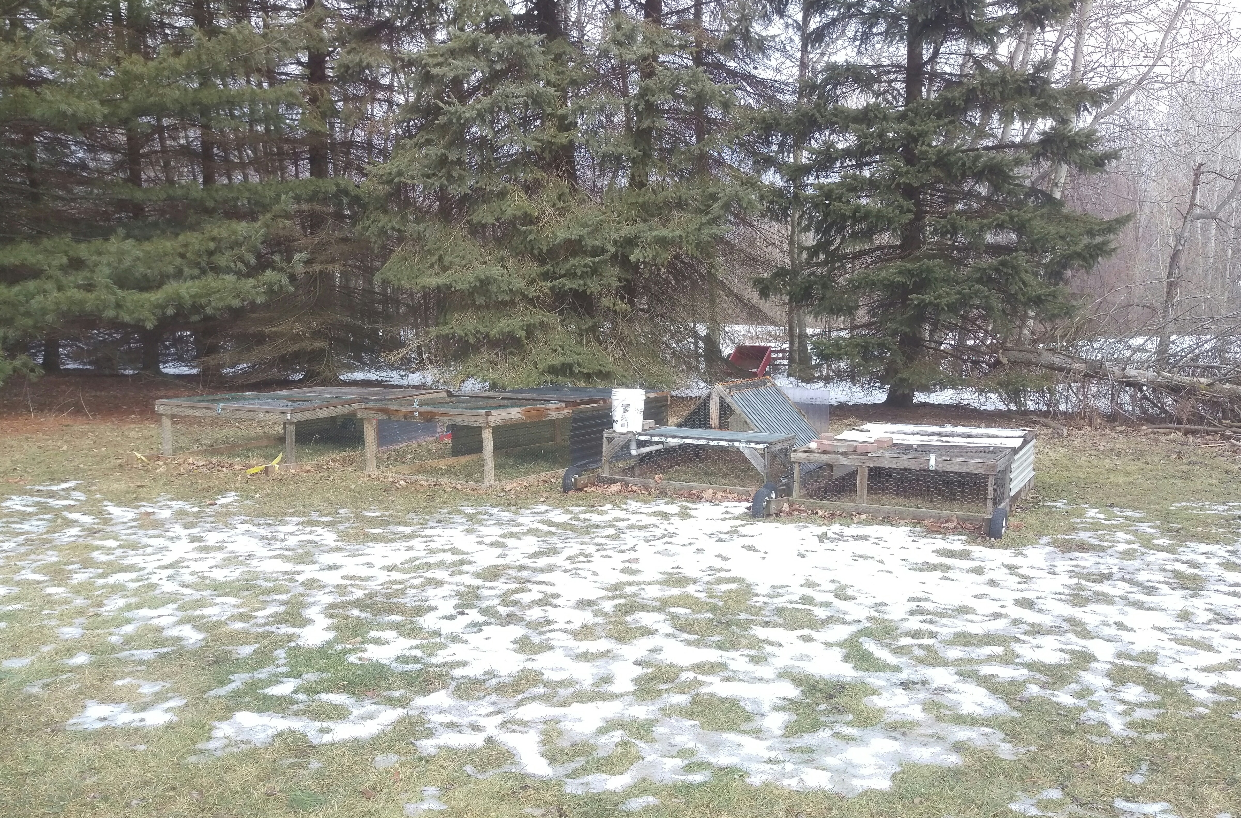

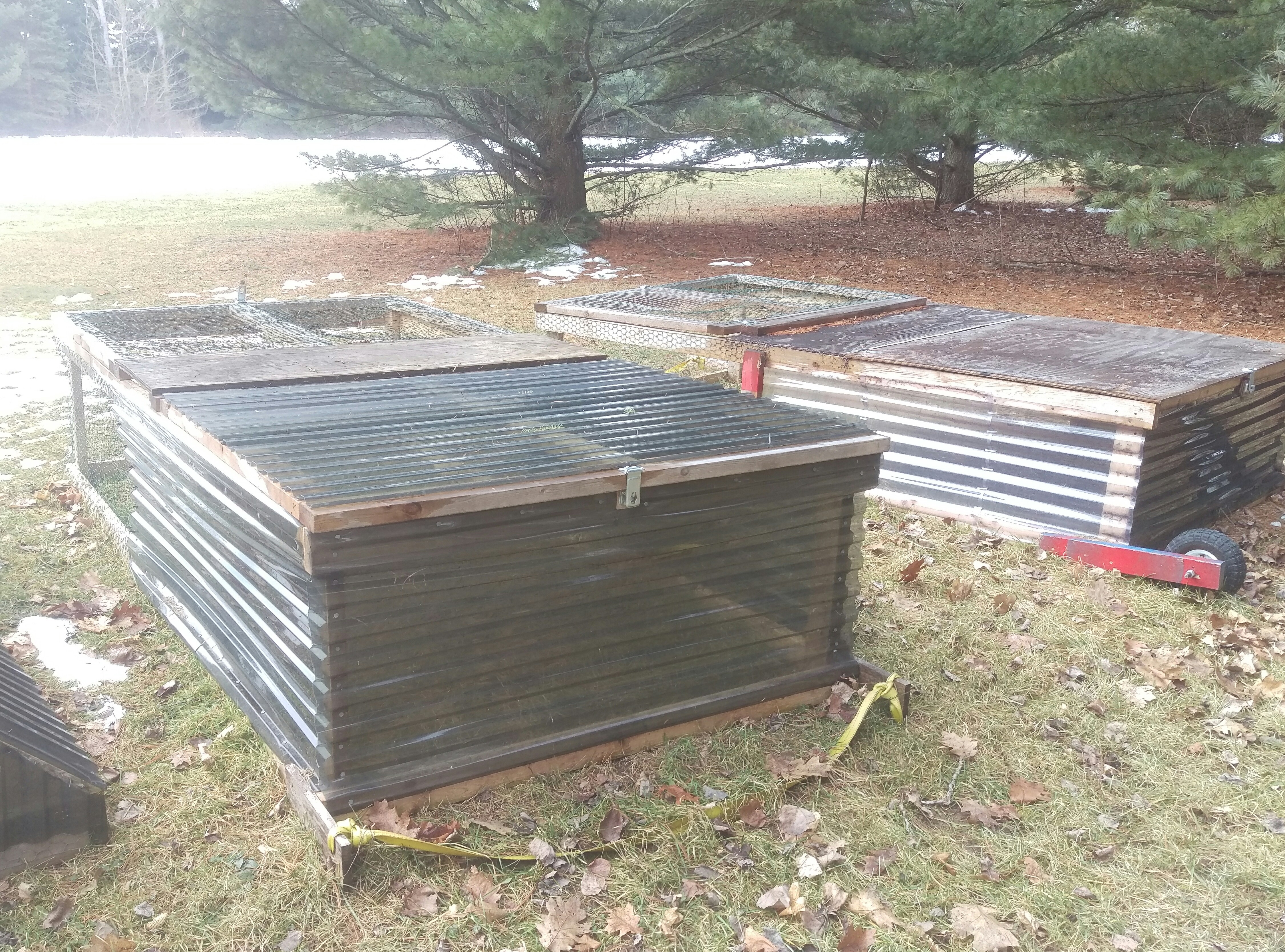

These are the four current ones we use, but the latest one (showcased) is the best and is the one we'll model all future ones after.
Go figure, is the simplest. That's how it usually works out, simple is best. We tried all kinds of different water solutions. Ultimately, we use 2 gallon chicken waters and set them on the ground. By the time the tractors are ready to be moved, they are empty. We just throw a few 5-gal buckets in the gator and fill them that way since these are out at pasture.
These are light, strong, safe, and easy. Easy also for removing birds when their time is up.
