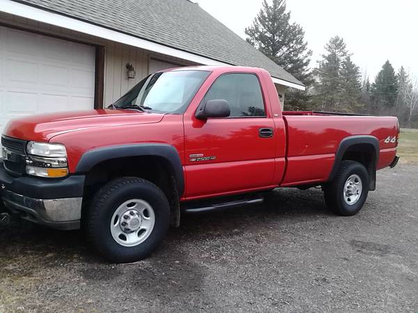

I should have added more information, but didn't want to make a long post even longer. The injectors were replaced at 170,000 miles. The price is $10,000.
I haven't run a carfax on it myself yet (i will), but the owner says it has a clean record. I haven't checked the truck out myself - I want to make sure I'm interested enough rather than wasting my and the owner's time.
I did speak with him on the phone. I told him that I would be crawling underneath it to check out the rust, and he assured me that it wasn't rusted.
This is a picture of the truck

It looks pretty nice, if you can haggle him down to 7k i think that would be a good deal.
/ Chevrolet 6.6 duramax #13
Shoot it's a bargain at 10, around my area anyway.
