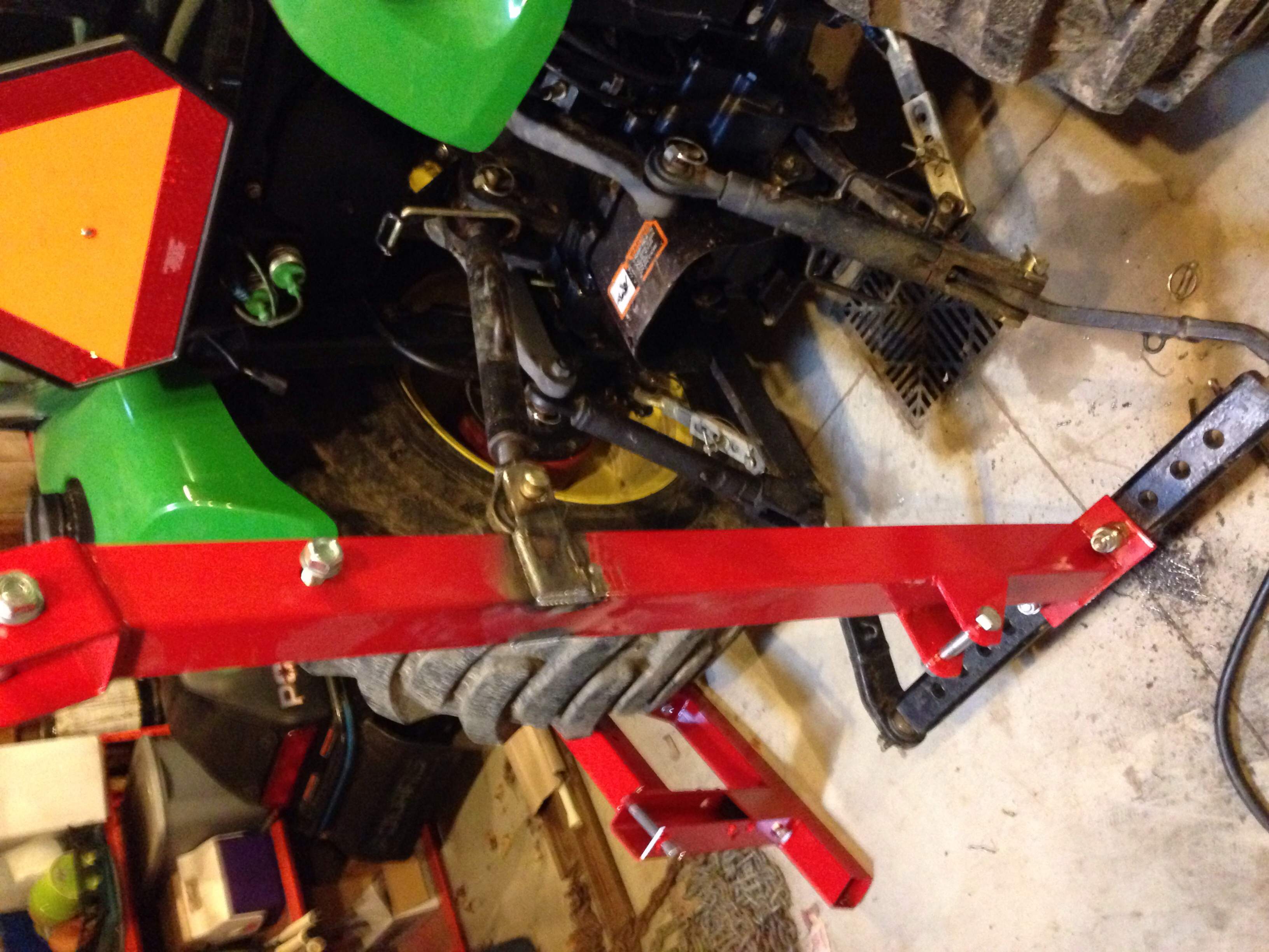

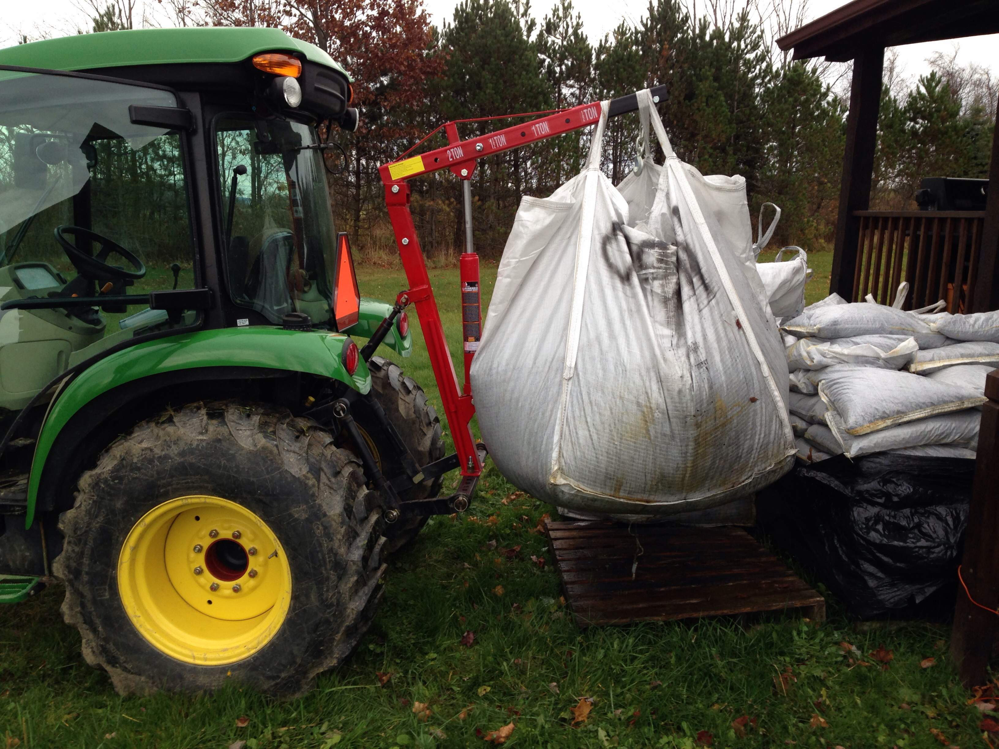

I am about to build one of these for my tractor, and I was curious if anybody has any new builds or info.
I need something to move around bulk bags ( super sacks) In the winter while the FEL is off , and front snowblower is on. I tried a regular boom pole, but it could hardly lift them off the ground because of how far back i had to lift. ~1500 lb

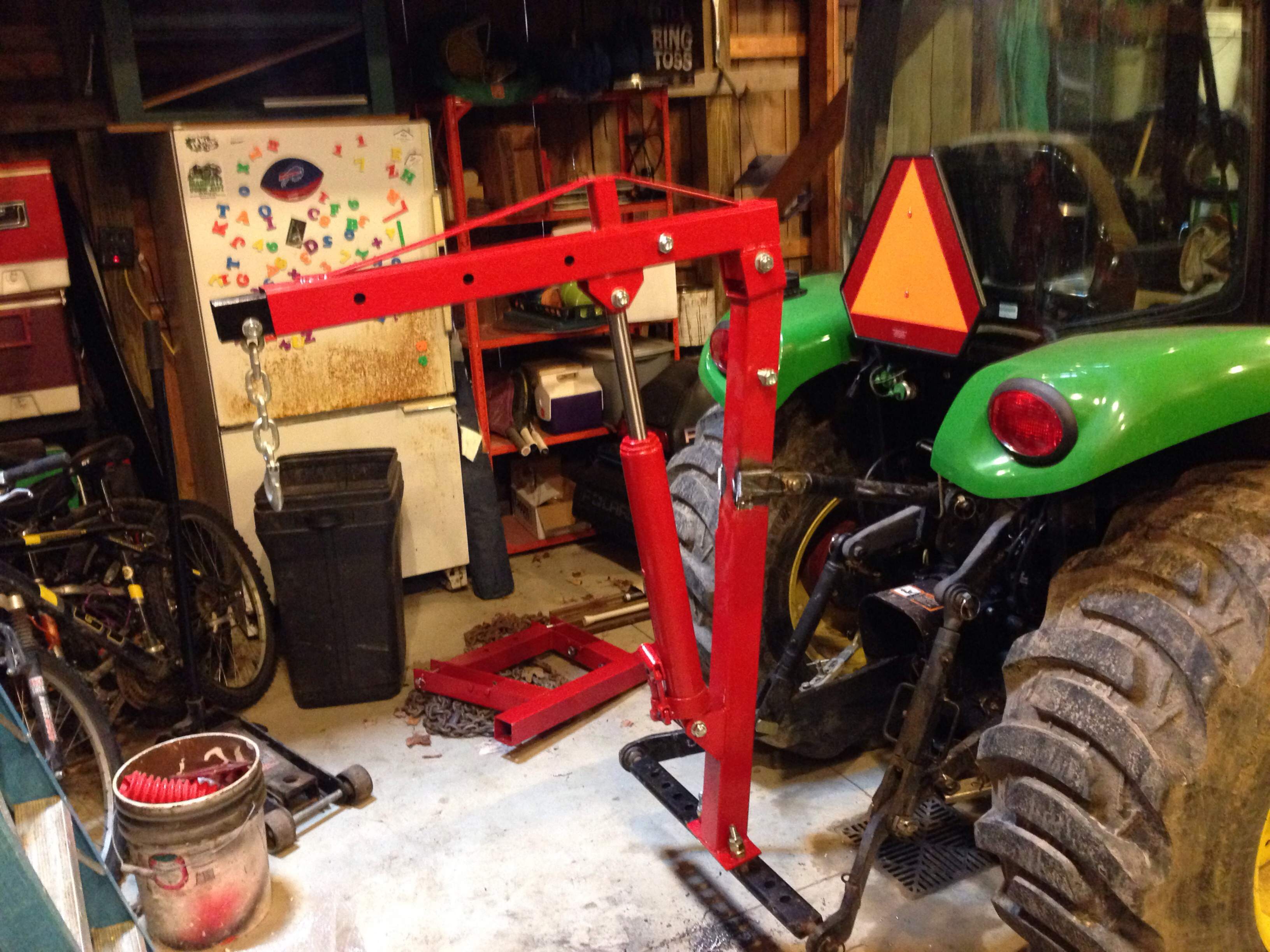

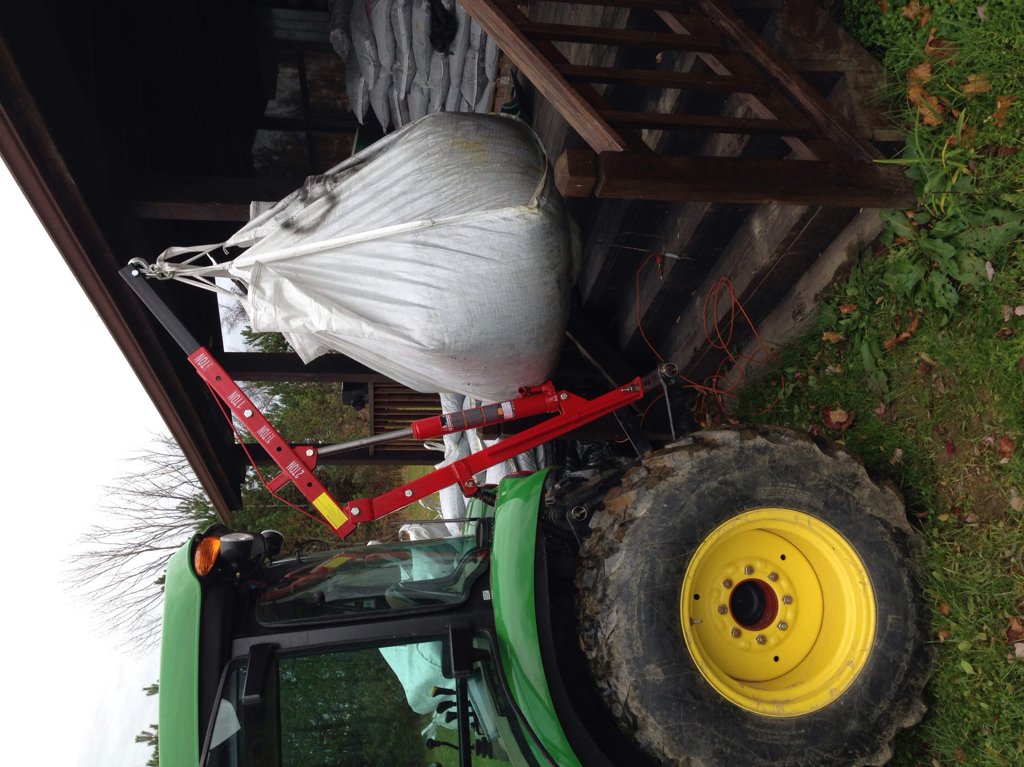

That would be awesome, and i have been keeping my eyes open for one, but this should be pretty low budget. I picked up a hoist yesterday, i will post photos when it's done.
   / Cherry Picker for Boom Pole? #29
It went pretty well. I had to drill new holes in the draw bar to get it bolted down. Looks like it will do the job. image.jpgimage.jpgimage.jpgimage.jpg
   / Cherry Picker for Boom Pole? #30
Olllotj, be careful! It looks like your toplink connection is a bit high and you may end up putting that post through your back window!
