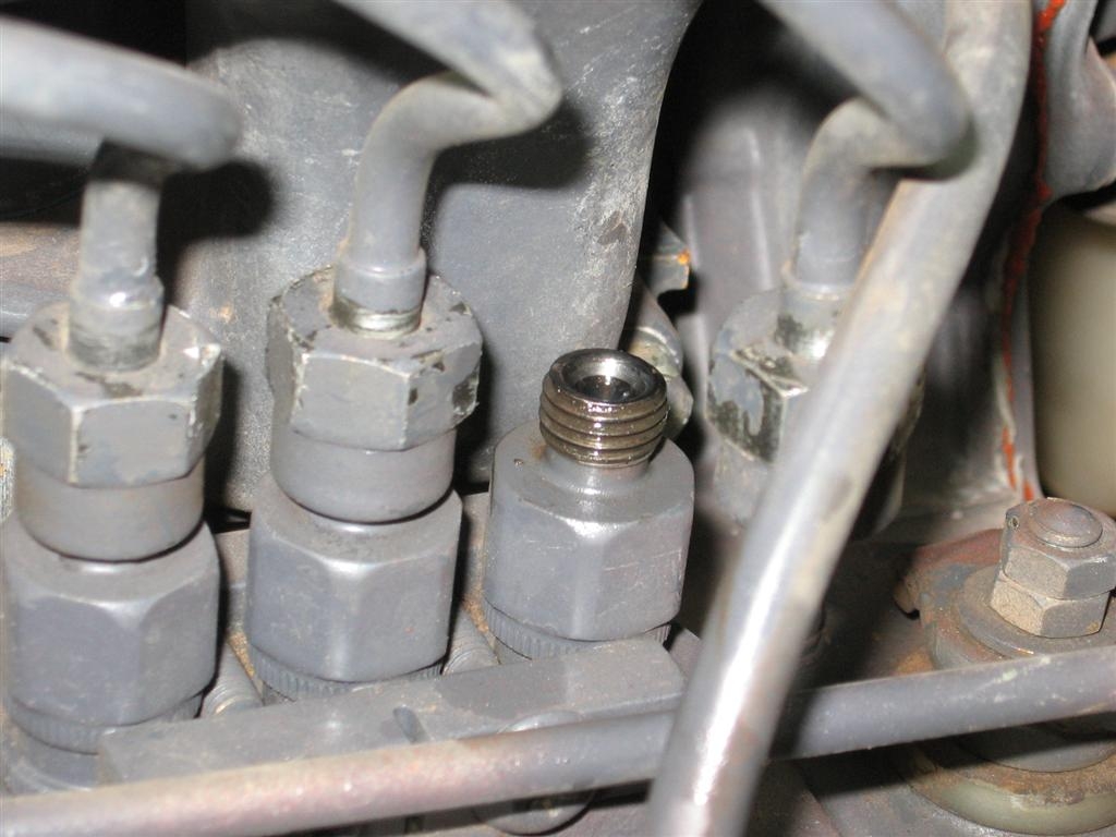

In my quest to conquer my overheating problem, this weekend I checked the timing per the manual. Really pretty simple.
1) I removed the fuelline on #1 injector at the pump, rotate the engine until you see fuel move in the delivery tube. You want to stop at the slightest movement.

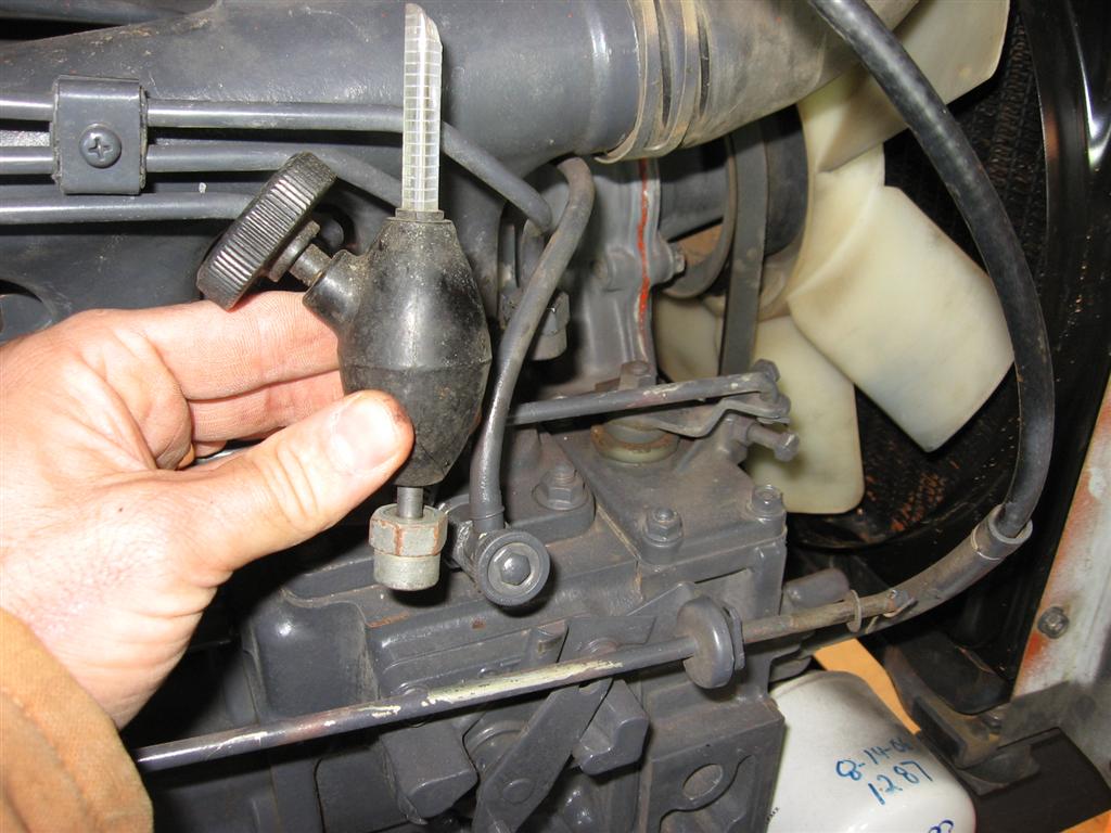

2) When I did this for a living I used this tool. Sort of a sight glass to easily see the fuel move. I would have to remove the intake manafold to put this on so I bypasses it.

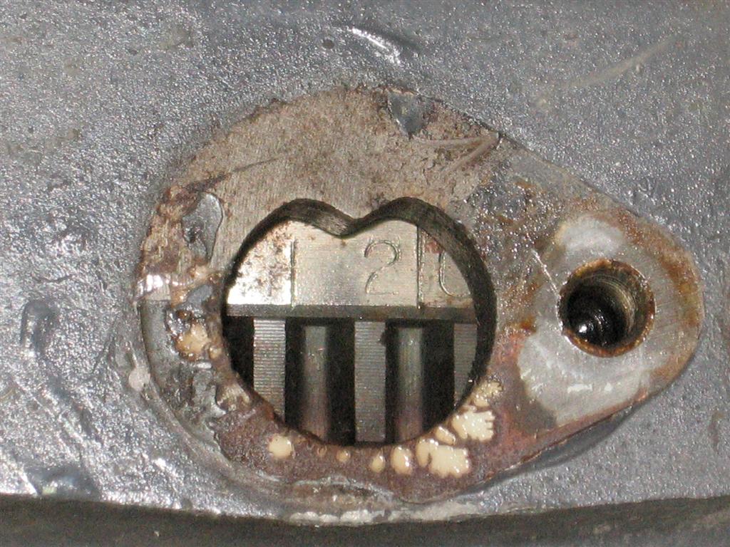

3) remove the side place on the bell housing and observe the timing marks. you can see the 20 degrees on the right, the line on the left is 15 degrees. Specs call for 17-19 degrees. The camera angle might be off but I'm pretty much right on 17 degrees.
No adjustments on the timing today. But those remembing my overheating woesI have some sort of good news. I ran the L pretty hard pulling a disk. The temp got a little over the half way mark and remained there. However it was a cool day, we''ll see this summer.

I never seen that type of tool before, but years ago on our Cat engines we would "flowtime" them. One would hang a spare fuel injection line onto #1 fuel injection pump "plunger and barrel" assembly, pressurize the fuel pump, and rotate the engine until the fuel almost quit flowing out the line(closing fill port internally) until you had 6 drops per minute=start of injection. Earlier, one would have installed a dial indicator probe on #1 piston and it would show how many thousandths of an inch before top dead center, then you would compare that to the service manual for how many degrees the dial indicator reading shows. Obviously, tractors with "degreed" flywheels are easier. The benefit of dial indicator on #1 piston, this that is takes any machining inaccuracies out of the equation(in case the alignment of crankshaft#1 TDC to flywheel #1 TDC mark was off). I just thought you might find this description interesting on the CAT engines. Nowadays, there is a machined slot in the counterweight of our crankshafts, you just set a magnetic probe into the side of the block at .040" clearance to the counterweight, run engine at 1100 rpm, then tell computer to electronically calibrate the timing(2 seconds). This way the ECM(computer) now knows the relationship between its electronic cam and crank sensors and the true mechanical TDC of #1 connecting rod journal= #1 piston TDC.

Scott, my pleasure. I figure a lot of folks here won't get into the stuff I do but pics are always fun to look at if nothing else(I seem to hit the posts with pics first :D). While I ordered the covers mentioned above, I also ordered a .20mm shim for the injection pump. I'm at 17 degrees now and the upper limit is 19 degrees. A little retarded timing might lower the temps if that's a problem...but I'll still be within specs. If I recall the shims advance or ****** the timing .5 degrees for each .05mm. You bet I'll post some pics or the pump removable and install. I'm figuring about 30 monutes because I think I have to remove the intake manifold.
