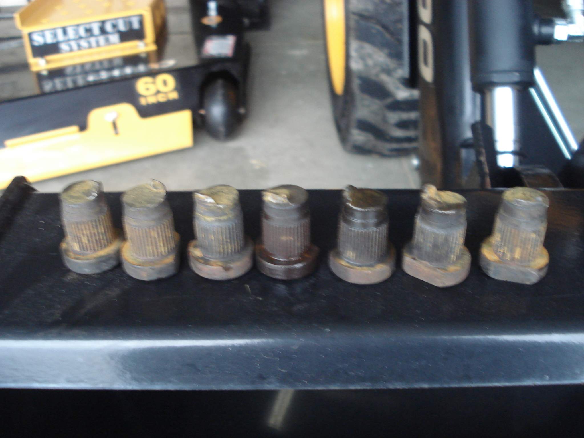

Or this could happen........
I've always done the cursory walkaround, visual inspection.....feeling rims, etc. But failed to put a wrench on the lug nuts on my 2010 30' gooseneck tandem dually trailer. This was after 2 recent 750 mile trips, and several others in the past. Shame on me!
Fortunately, I was on a secondary road at night with a light load on, not going fast. Felt a thump as I drove over the second wheel that came off.
Didn't help matters I'm sure that I was playing with the trailer brakes during the trip....generating some extra torque on the loose nuts. It actually elongated the lug holes on 1 rim rendering it useless. Must've sheared all 8 off at the same time.
Could have really been ugly. Lesson learned!!
I don't know about that. Hard to tell from the photo but some of those breaks look older than the others. You might have been down to the last three or four before it broke depending on how the remaining good studs were spaced around the wheel.

I sold my King Kutter finish mower to a guy a few years ago. He was backing his trailer down my drive behind his Cherokee when one of the wheels nearly fell off. Luckily I had a die and a few spare lug nuts around to get him back going. The other wheel was loose also on the passengers side but the drivers side will loosen quicker due to rotation.
I carry a torque wrench with me when I tow. I run over all the lugs at 100 miles then each day. Good news is the studs are not that hard to change.

Since most of you know I'm an advocate of torque striping, I'll do it here too.
Simple process:
Torque the bolts or nuts to spec
Use a contrasting color paint marker and mark a straight line across the stud threads, nut and adjacent wheel surface (if the trailer has studs and nuts). If the trailer uses bolts, paint that straight line across the head, side and adjacent wheel surface.
As long as the stripe isn't broken and the painted lines align, the bolt or nut hasn't loosened..a quick, easy visual check.
Torque striping fasteners is a wide spread industry practice on fasteners that are not removed and re-installed on a frequent basis. This includes aerospace, BTW.
