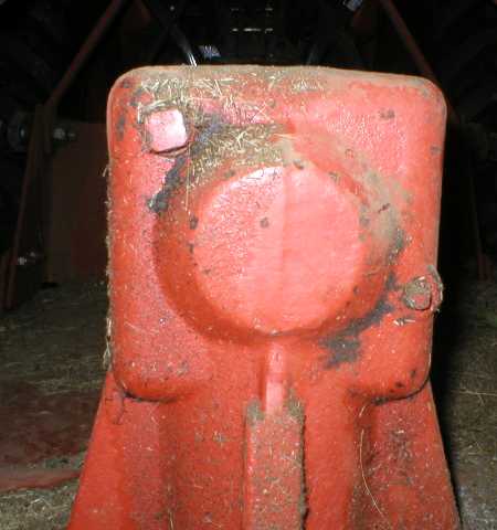

Here's a picture of the back of my gearbox on the SE5. Is the oil supposed to go all the way to the top filler plug, or just to the bottom plug? I filled her all the way to the top. If its only supposed to go to the bottom one, that explains why it wouldn't drain out of there.
I hope I haven't done any damage by overfilling to the top plug.
   / Check your gearbox! #15
Alan, you fill from the top until it starts running out the bottom. I doubt you done any damage but I'd drain some out before you blow a seal.
