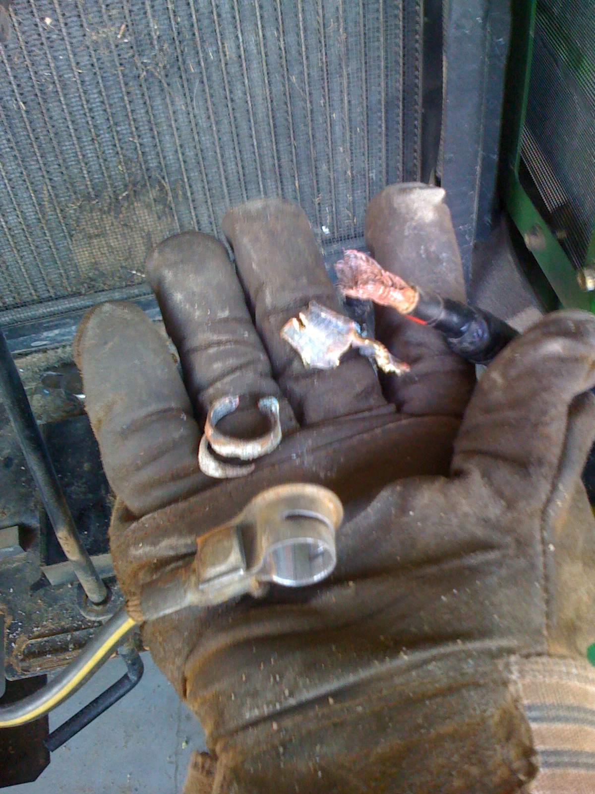

Saturday my 2210 wouldn't start. Parked indoors, 240+ hours and the battery terminal had corroded through.
You know the symptoms turn key, starter engages, clicks but will not turn, dashboard lights go dim...bad battery/connection. I popped the hood checked the battery and the positive terminal looked like it had a broccoli and cauliflower salad where I expected to see a copper terminal. I'm always surprised by the amount of corrosion on batteries, but the colors and amount of corrosion I saw here were like Dr. Suess: yellow, green, white, blue.....
Anyhow I got a brush, channel-locks and some wrenches and got to work. I didn't think to get a picture until I was on my way to the hardware store, but then finally took a couple to show you guys.
In pieces the round part at 11:00 is what's left of the original terminal. The shiny piece at 12:00 is the terminal end that attaches to the cable. It's shiny after working on it with the channel locks.

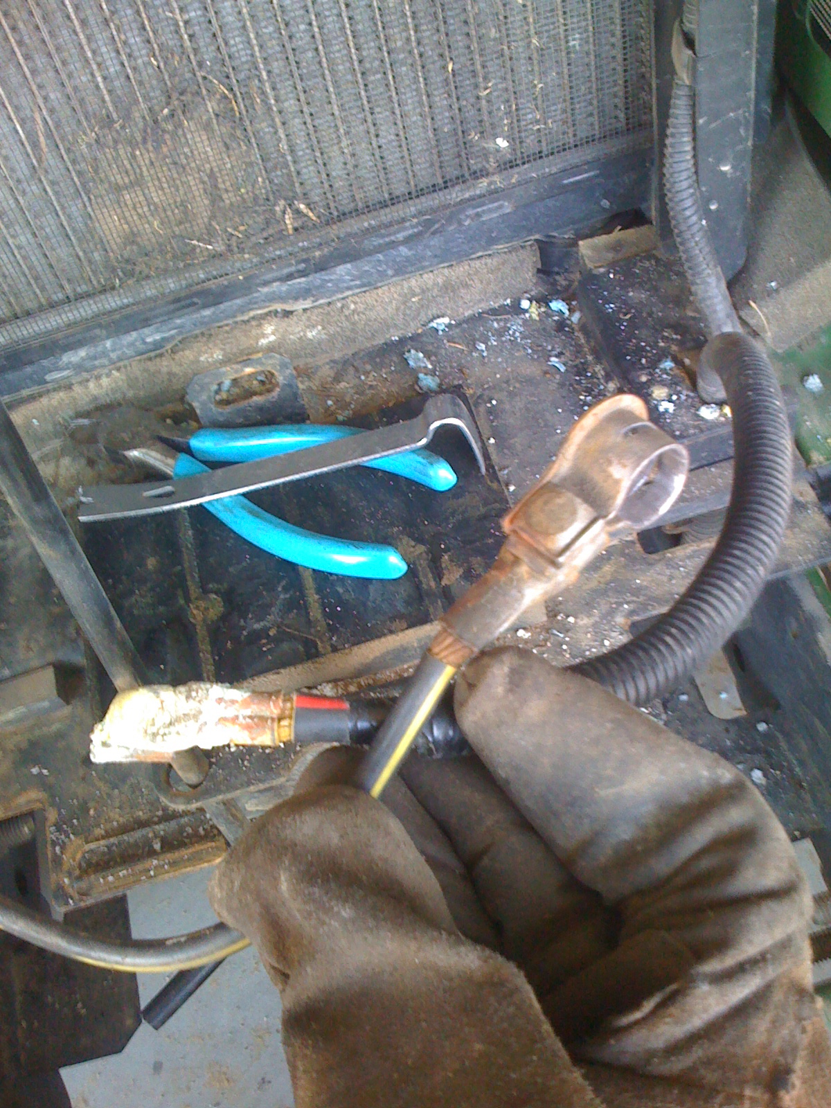

Background is mid fight getting the pressed terminal end off the actual battery cable. It only show some of the corrosion remnants, because the rest are already on the floor, but I did mention the colors.
It's only a $5.00 repair for a new terminal, but it did take an hour from the time I wanted to start the tractor until I actually was able. I'm glad I won't have to do that this winter now. Now, I can probably wait a couple years until I think about that battery terminals again. The rest of you probably shouldn't!
