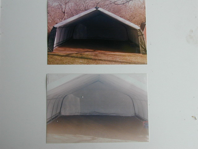

Cheap Tractor Shelter Update
I got the HF "cheap tractor shelter" about a month back. Like the rest of you I figured for $129 how could I go wrong? Well it was good for a little rain but one 2-3" wet snow storm and this thing is a crumpled mess. It wouldn't be so bad if I only had to take it to the dump but my shiny new Kubota is all scratched up and the exhaust stack buckled! /w3tcompact/icons/sad.gif
/ Cheap Tractor Shelter
#26
Re: Cheap Tractor Shelter Update
Sorry to hear you had some bad luck. Seems strange the snow caused the feet to bow out so far the top fell in. (Is this what happened?) Did it bend the steel pipe?
How did you secure the feet to the ground? I used 12" nails instead of the dinky 6" rebar spikes they included and, based on some suggestions here, I also created about half a dozen guy-wires to keep the thing upright in the severe winds I encounter on my place. (I used some steel cable I got from Lowe’s to mfg. my supports - I forget how many hundred pounds it was rated for, but it was several which I believed would be sufficient.) So far it has withstood gusts in the 40+ mph range and saved my tractor from several nasty hail storms while incurring no damage. (Amazing how much sturdier it became when the guy-wires/other mods were added - I don’t think it would have came out with such “flying colors” if I hadn’t “tweaked” the original design a bit though.) Of course the key to adding the strength was to get everything tight before hand so that no "wobble" was present and allowed to "grow."
Did you do any of the other mods such as pinning the uprights into the feet/uprights to the top to keep them seated in the event of "updrafts"? (e.g. to prevent the top section from going up/down like Dorothy's house.") I could see how it could buckle pretty easily if the bottoms of the supports were allowed to "slip their shoes."
I'd be curious what you believed the failure was so that others who decide to continue to use such shelters (such as myself) might take your observations in to account. I'm still confident in my shelters stability and value, but am always looking to improve things as well.

/w3tcompact/icons/sad.gif..Maybe your home owners insurance will cover the repairs??

Ranchman -
Actually I employed your modifications as I believe they were all good ideas. I had all the stuff for guy wires and such already in hand when the Harbor Freight shipment arrived after hearing about your installation here on TBN.
The unit was simply crushed by the snow load. It failed at numerous joints along the ridge and along the sides. The tubing buckled at the joint insertions. I don't think any practical modifications could have prevented it. It would seem to be simply a design limitation: tubing too light and roof not pitched enough to shed snow. Fortunately those TBNers such as yourself and others in the deep south needn't worry about this too much but bear in mind it was only 2-3" of wet snow.
Ed

EdK - Was it level? If not, it would buckle easier.
/ Cheap Tractor Shelter #33
Yes, it was pretty level. I have a spot to park my tractor that was built by the previous land owner as a parking spot for his 22-wheel Kenworth gravel truck and I put the shelter there. I would estimate the plane upon which the legs rested was flat within an inch over the 10'x20' footprint. However, I did't go as far as shooting the grade with a transit or laser level.
