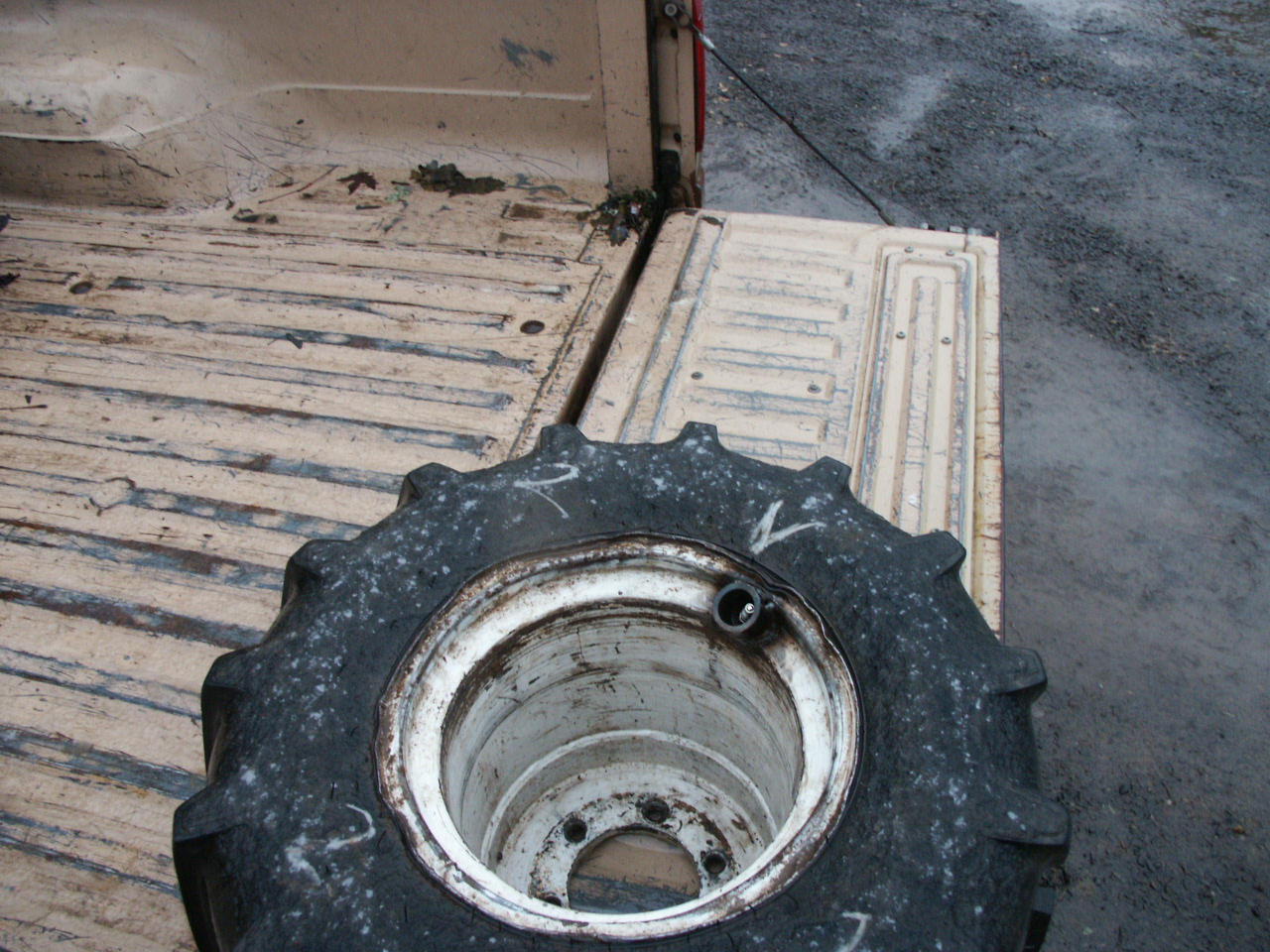

/ Cheap Tire Changer for PT
#14
No setback. Flange welded to the edge of the rim There is a ring spacer between each rim (about 2" by 1/4" by 12" oval) ring that divides the tires. All rims are identical, you just turn one over the motor, or pointing out, with the spacer inbetween.
There are two sets of bolts on each stud, one for the inner tire and one for the outer.
I don't really have any good pix of the rims, here is the best I have.

How in God's name did all those dings get in those rims. IEDs? They look like Iraq war surplus stuff. :eek:
Ain't that nice? Mostly that is the way some of the rims came. I was concerned, but the tire guys said they were fine.
I have been cutting alder groves on my property, and the stumps range from 1" to 4". They really bung up the rims..
