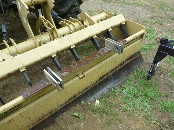

Found it...
I used a large piece of angle Iron, I believe it was 4"x4" and quite thick, then I welded two brackets to the angle iron.
I was going to drill two holes in the back of my box blade, and through the angle iron to secure it. You can see how the lip of the angle iron rests on the top of the box blade. I was going to use grade 8 bolts to secure it so I could remove it if I wanted to.

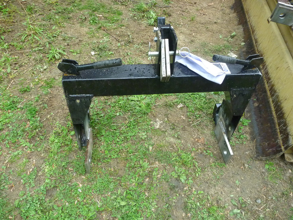

Then, I welded two brackets to the quick hitch frame, and would use bolts to secure it to the other brackets....
