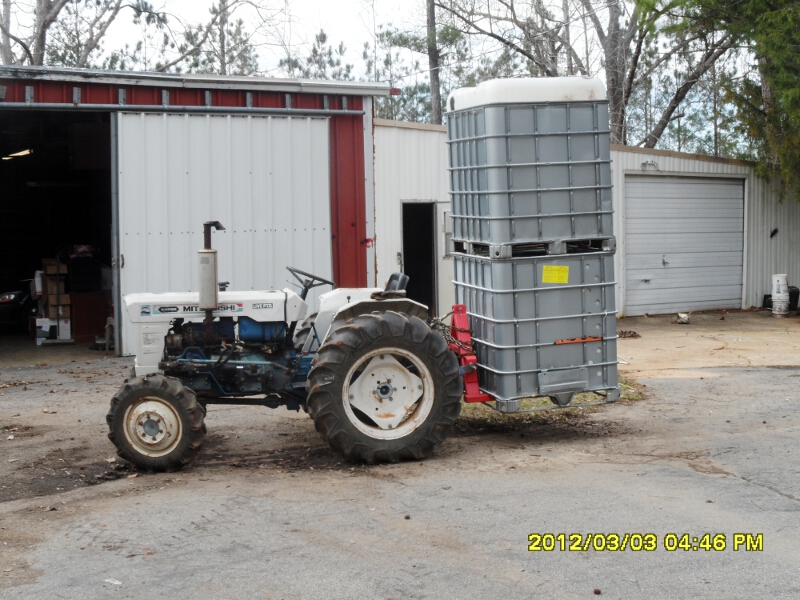

Getting back to the original question: get water to the horses and run the septic pump, if the septic pump can go several days without running, can you store water for the horses in those 275 gal. totes where it wouldn't freeze? In a long outage, perhaps you could find somewhere to refill them, hauled in a pickup.
The water should be safe for you and the horses if you add treatment to it and replace with fresh water every 3 months or so.
/ Cheap Generator #33
Totes - easy to fill and transport.
I keep one filled with rainwater running off a metal roof. Be careful toting them partially filled in a SRW pickup. I saw a lawn co. truck w/ one about 3/4 filled do a tight turn at low speed in our cul-de-sac and it about went on two wheels as all the liquid sloshed to the side.
