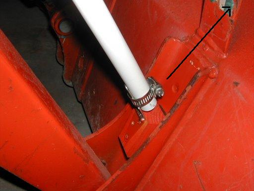

A loader bucket position indicator is a handy thing to have and my recently acquired BX2200 does not have one. I cobbled the following out of scrap and it works fine.
The rod is 1/2" pvc attached on the bottom end to a small strap hinge with a hose clamp and running through half of a 3/4" pvc coupling as a guide at the top. The hinge and coupling are secured to wood mounts shaped to fit and glued to the machine with JB Weld. The glue spot was sanded and wiped down with acetone, and seems secure.
The rod would probably not last long in brush, but it would be easy to replace, and I don't have much brush.

Just above your white pipe (black arrow) is the factory installed bucket level indicator, the top edge of the level indicator is parallel to the bottom of the FEL bucket, so even if your tractor isn't setting on level front to rear, that one will still let you get the bottom of the bucket level

Thanks Milkman. I wondered what that bracket was for. Learn something new every day

The indicator you made is so much handier than the stock strap. I have a similar indicator on mine. When working a pile you can set the level of the bucket before lowering it and then just drive into the pile. The tape reference will allow you to adjust the level slightly so that you can either dig more or less or the same as the last time. I wouldn't want to be without it now that I have it.

Thanks for the comments. I've gotten used to this thing and am happy as a pig in clover with it. I find myself referring to it constantly. Not only is it accurate and useful, but since the cost was basically zero, it also makes me feel virtuous.
