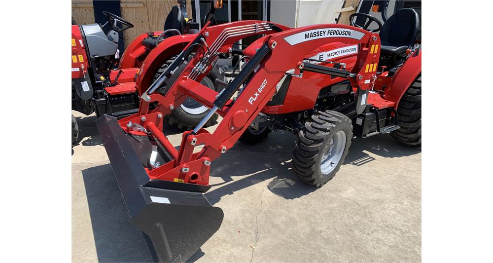

I agree with your opinion. I said earlier I suspect the decision to omit the extra pivot lever set was possibly to save a few bucks/increase profits on this model loader. I'd like to talk to my older long-experienced dealer about his choices while ordering them. I'll get around to it eventually.
It never (oops, I mean had not yet...) occurred to me to think about making a set of the extra pivot levers. Neat idea if on a tight budget or just like to tinker and fabricate metal things. Might even open ways to customize the mechanics. Otherwise surely one would just order the parts and install factory ones. One obvious benefit of your homebrew (and of the factory parts) would be to prevent the extreme extension of the rods in the bucket cylinders during full dump. Also the situation where the sharp tip down (prohibited type back dragging) has the worst potential. That's the awkward position where the bucket cylinders are most vulnerable. Using the extra pivot lever hardware means those cylinders are less extended by around a foot or so at full dump position. I'm fumbling for a good picture and the best-found is of a FLx2407 which I'll insert below. Fine for illustration. Just to show the much lesser extension of the cylinders for a given amount of dump. That's a huge help when heavy compression forces are put on those cylinders be they approved or prohibited large forces.
OBTW -- just noticed by studying this photo that the bucket cylinder has a much greater mechanical advantage in forcing the the bucket tip down (or resisting it coming up) in the exact position shown here than it would if attached direct to the SSQA hitch adapter hardware. This has not been mentioned in 114 posts so far has it ? At least a 2:1 mech advantage at the angle shown. That translates to twice the compression force on the cylinders in a given circumstance without the red levers ... like in any badass backdrag, or maybe pulling the tractor forward when stuck in the mud (which I have done on both JD and MF in axle deep tough spots ) , right? AND the same MA of 2:1 or better applies when digging forward putting the cylinders in tension rather than compression. Hmmm. I think I strongly prefer the extra pivot lever version.

   / Cheap FEL cylinders keep bending #116
Take a look at the nasty disadvantage the overextended bucket cylinders are in in this photo from a TractorHouse sale ad. This is an FLx2815 FEL like the one in the OP and without the pivot linkage at the tip of the loader frame at the SSQA interface.
Just letting this image soak in, I see 2 or 3 hazards. 1) driving forward if the standard bucket tip catches on something (edge of concrete, stump, pipe, etc.) the rods are already down against the loader frame and will see force tending to bend the rods. The bucket folding further up under the front of the tractor. 2) If the bucket tip in position shown is forced downward on some object like a rock or log by lowering the loader frame that also puts bending pressure on the rods. 3) If there is any hydraulic "dump range" left at this point that can also add to bending force on the rods that are already against the frame.
To me this is an oddball circumstance that really should not happen BUT it obviously can happen. And Murphy's law says it will. The rods would be protected from all 3 of these hazards (raised up away from the loader frame) if the pivot linkage were in place.
