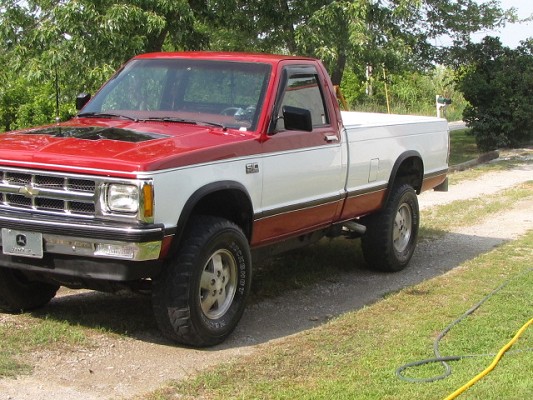

In about two months we'll be closing on a property at the end of a 1/4 mile gravel road that I'll be responsible for maintaining. We're coming from a half acre lot on a public road so I have some equipment (lawn tractor, chainsaw, other OPE, etc...) but I don't have a CUT yet and and will probably need to get by without one for a little while. A buddy has an old 2.8L V6/Automatic 4x4 S-10, similar to this one (body is in much rougher shape):
He'd have to dump $2000 into it between an O2 sensor, new catalytic converter, exhaust, etc...in order to get it to pass NJ inspection, so he's willing to just give it to me. I'm thinking of doing the following:
-Weld up spiders in the rearend
-Fill all four tires with liquid ballast
-Fit v-bar chains to all four tires
-Build a weight box out of lumber that I can load with rocks, concrete, etc...that would be secured between the cab and the rear axle
-Fit/adapt a cheap plow
The idea would be to just keep it as a dedicated plow truck that will never leave the property, plus I'd probably find some other odd jobs like pulling, etc...to do with it. I think I'd certainly have enough weight and traction, but would the 2.8L give me enough power for snowplowing? We're in Northwest NJ, so most of the time I'll be pushing off 6-8" at a clip. If I know we're going to get feet of snow I'll be out there during the storm to get ahead of it. Not to mention it would be nice to have heat and windshield wipers :D
Keep in mind that MANY MANY people plow snow with just a 4 wheeler.
Pushing 6" of snow 20 yds is no more of a problem then pushing that same 6" of snow 200 yds.
That S10 will have plenty of power to push a 6.5' or 7' plow without doing anything to it other then maybe rear chains and some extra weight in the back.
My F150 has pushed over 14" of wet snow with only the rear chains, no extra weight.
If you have a problem, just take a smaller bite and make a few more passes.

Lots of posts here from people who've never plowed saying this won't work and you need a 3/4 ton truck. Rubbish, I say. I have a 6' Meyer on my Jeep Wrangler and it is awesome! The Jeep has no problem pushing it, and I actually wish it was a 6.5'. In college I plowed a church and many fraternities/sororities with a'78 Chevy with a 250 straight six. That was in Houghton MI. (Not many places get more snow than that!!) It also had plenty of power and weight, and made a great plow truck, while being good on fuel.
A little S-10 would make an awesome driveway plow. You'll ideally want a 6.5' plow for it. A 6 or 7' would also work, but a 7.5' would be too big. The front end will be fine. Grease the balljoints and tie rods, and crank up the bars a bit to account for the weight and it'll probably never give you trouble.
I'd recommend against liquid ballast in the tires. It's not a tractor, and they're not big enough for it to make a difference. Skip the V-bar chains too, unless there's a LOT of ice where you live. Just put a set of cheap winter tires on it and toss about 300lbs in the box right at the tailgate and it'll push snow like a champ.
I'd also recommend against welding the rear up... If you leave it open, and you spin a bit, it'll probably still push straight. When you weld up the rear, it'll head downhill or whichever direction the plow is pushing if you spin at all. Not so cool when that happens, and you'll end up spun into a snowbank.

Your old jeep had a straight axle. That is a big difference in my book vs. a S10. The IFS is why keeping the plow as light as possible is needed for such a project.
Using a winch to raise and lower the plow like 4-wheelers do instead of hydraulics might be a big step in the right direction with regards to saving weight.
a modern Vee plow is right out of the equation.
I agree skip the tire chains and welded dif. Fill the bed with firewood or something.
