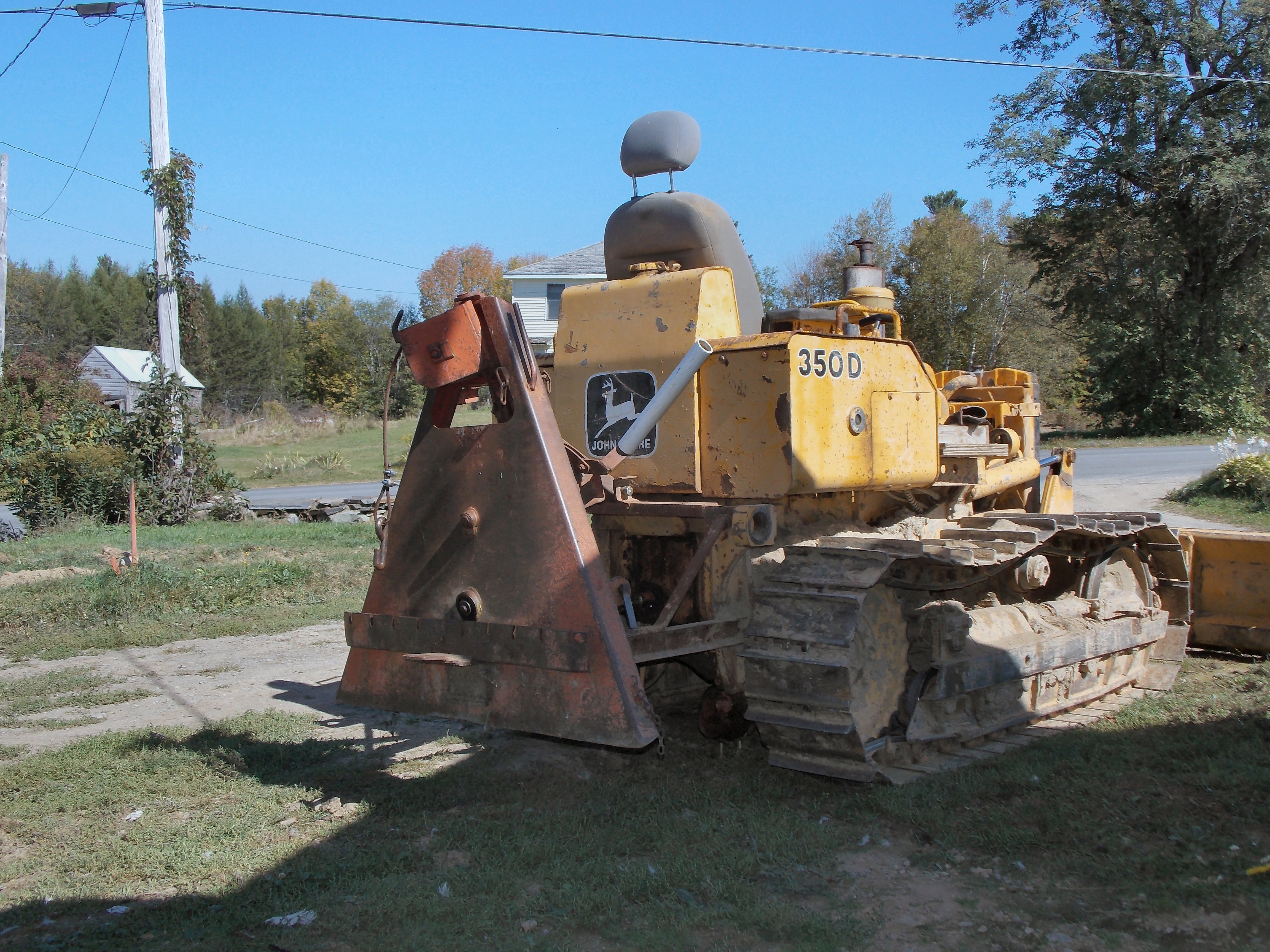

/ Cheap Bulldozer Winch #2
John deere 350 winch, complete and excellent condition (Johnson,Vermont) This guy has a few plus parts

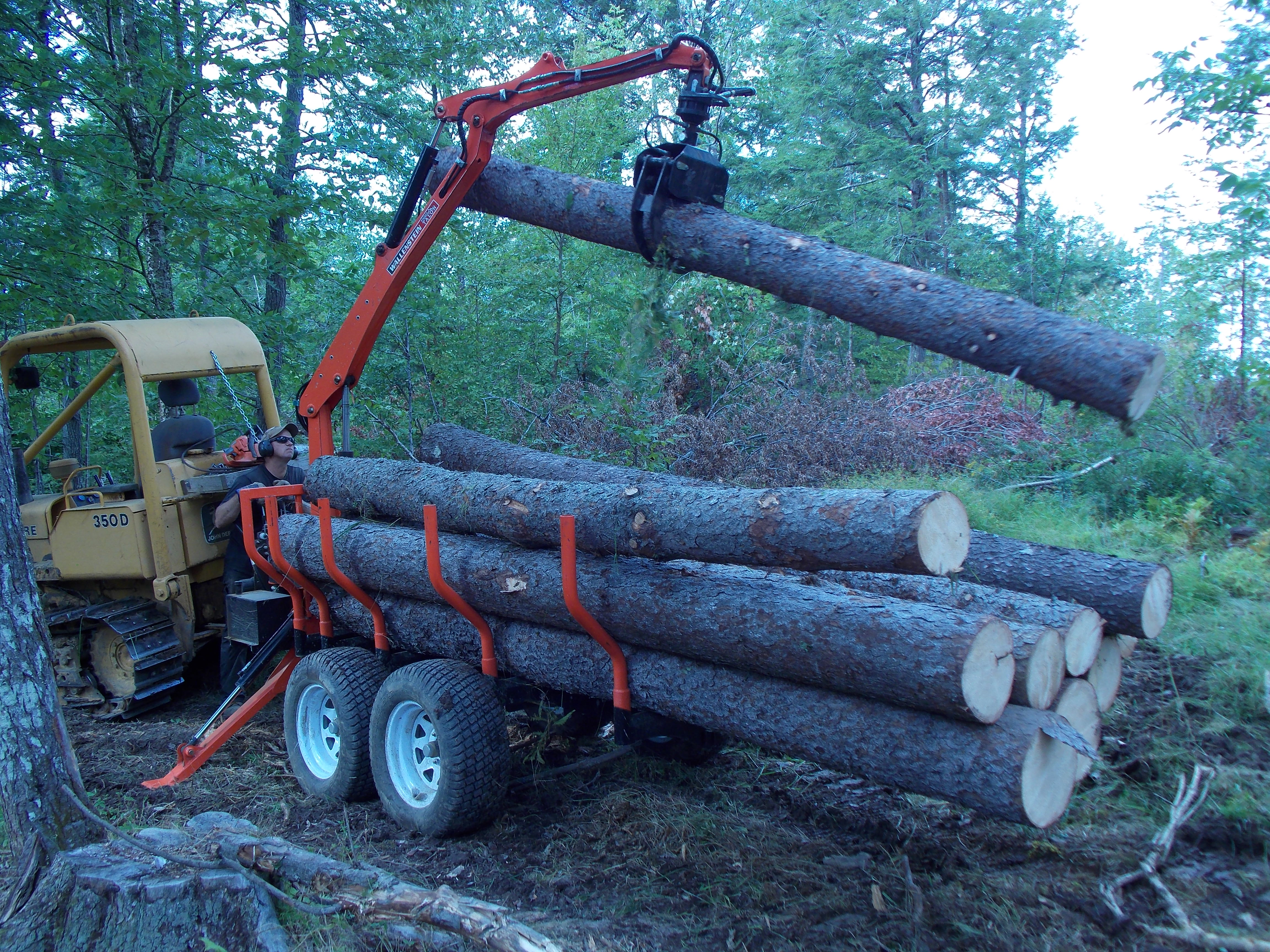

My ultimate set-up is actually a trio, but sadly I have not had it configured this way yet to take a picture as I have just been logging with my skidder. Hopefully I can word it properly so you can understand what I want to do.
Basically it is my Bulldozer, with attached Fransgard Winch, with my Wallenstein Log Trailer hooked to the hitch on the winch. In this way, I can fell a tree, limb it, top it and then using my winch; drag the tree close enough so that I can pick it up with my grapple and load it on my log trailer. I have used this method on my Kubota tractor and it works well, it just would work much better with my bulldozer as it has more traction.
The Log Trailer works good because I can lift the log off the ground so I can cut the tree at waist height instead of on the ground where I might dull my saw. I can only get 5-6 trees on before my trailer is full, but they are very clean and cut to length. (I hope I have explained this well enough so you can picture what I want to do).
Here is my Log Trailer, BUT not with my winch attached to my dozer.

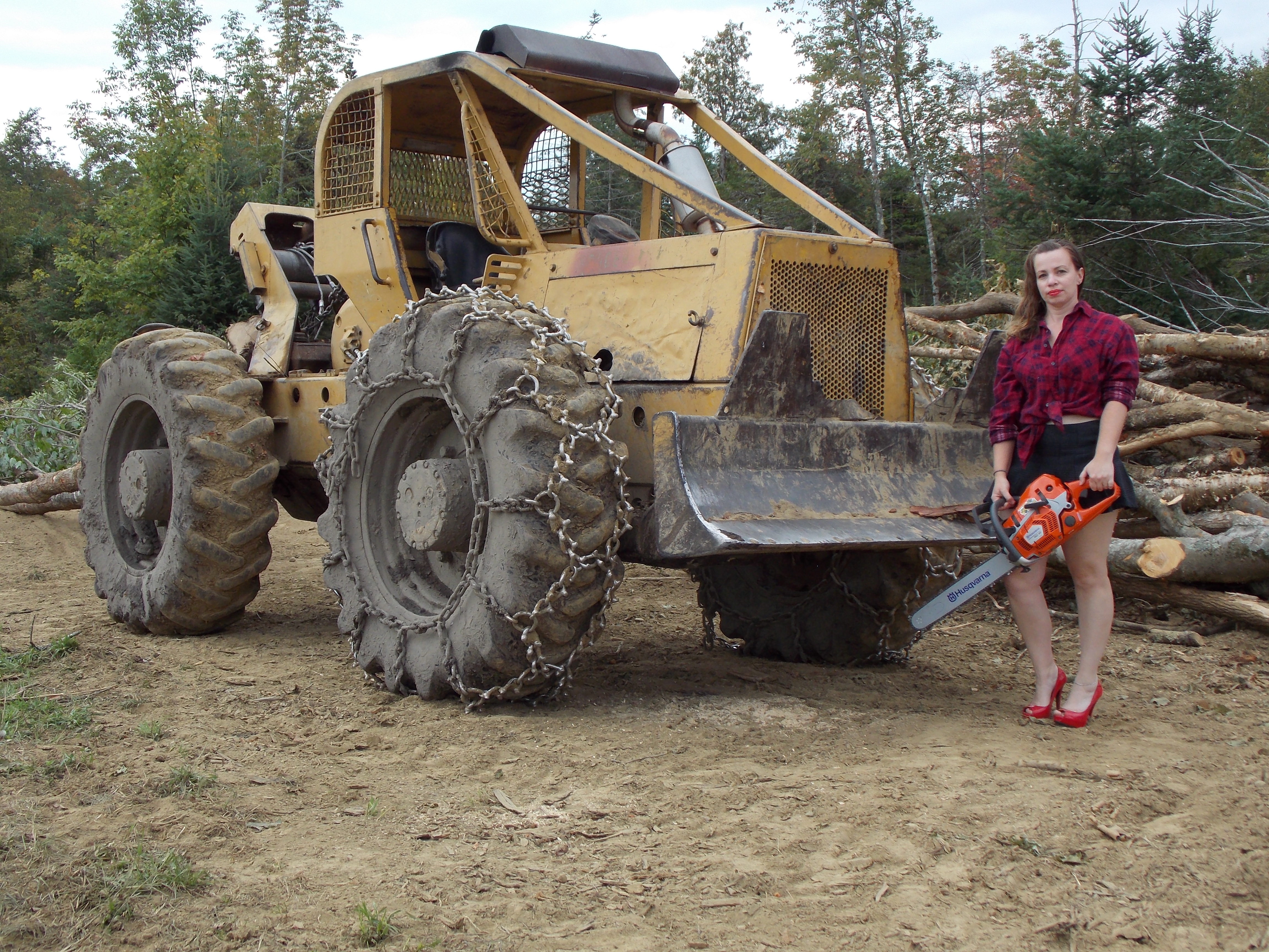

Looks like a great solution and can't beat the price. What year is the dozer? Need to see pictures of skidder next.
My dozer is a 1988 John Deere 350D, so it is of the last year they made them. It is in pretty decent shape, brand new undercarriage throughout, then some extras like an auxiliary reverser cooler. Everything is really tight except for the blade. I need to line-bore the pins and refurbish the blade control lever as it is sloppy. Some lights would be nice, along with a paint-job, but it is my baby good or bad. But what the heck...let us throw in some fuzzy dice on the list too I guess.
As for the skidder; it is a 1979 Clark 664C with a 453 Detroit instead of the 353. The saw my wife is holding is a 2017 Husqvarna 562, but I am not a huge fan of it. I miss my Stihl MS 461, but it went to cut the big Eastern Hemlock in the sky when said skidder mashed it into the ground.
