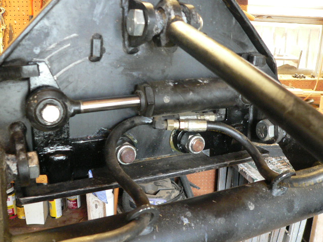

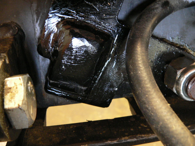

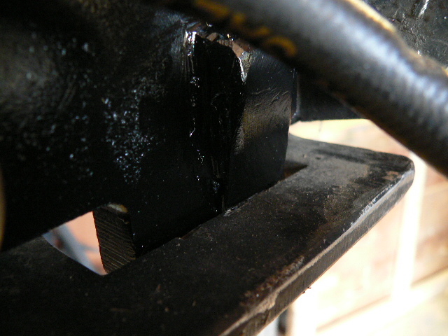

Someone posted a fix for the noisy chatter of the QA plate when mowing. That fix consisted of three bolts and tapped holes at the top of the QA plate. He said it worked fine to quiet down the chatter but was a little hard to switch between between attachments. Sorry but I can't find the link or remember who wrote it. Well that got me to thinking................
Why not use the locking dogs of the QA assembly to pin the QA plate tightly to the tractor. The dogs move out the way to provide clearance for swapping attachments and it works for all your attachments. So what I cane up with is two steel wedges welded on the dogs. Have a look as the work great.
Swamp

Sounds like and looks like a good idea. I can't think of any negatives. Please update us as you gain experience with using it.

Hey swamp, that was me. Ive since stopped using two of the bolts because it made it tempermental hooking up.
I did however take the same idea as you used except instead of rigging the quick attach , on each individual attachment i installed two 3/8" set screws through the attachment and then while the attachment is mounted, adjusted the set screws to take up slack pushing the quick attach tabs snug to the slots....tough to explain , idid it to the LMB and the mini hoe.
The reason i chose to work it on the attachment end rather than the quick attach end like you did is i didnt want to rely on every female attach plate being exactly the same.

Great job! I have the same issue and I had thought about doing this or putting a layer of industrial belting on the attachments that aren't snug.
I did have one concern about wedging the Q/A plates, which was that the wedges might loosen, because there would be active pressure driving the Q/A cams to loosen. What do you think?
Since you are doing the experiment, it will be interesting to see if it causes you any issues.
Thanks for sharing the fix; it is great to see these creative solutions!

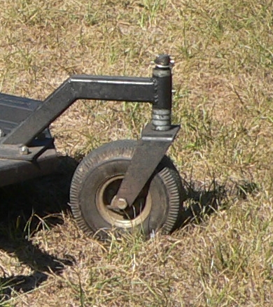

I am happy to say that my PT mowing is MUCH less noisy. Matter of fact, now that the QA plate noise is gone I found that the spacer rings on the front wheels were almost as bad at making noise. That was easy, I took them off and stored them in the tool box, noise eliminated! For a quieter ride, something like this is a must do.

Swampman. Can you keep us (me) updated on this upgrade. The only concern I have with it is that the wedges get stuck down in there if I am doing extreme pushing / pulling... That they settle down in there and won't come out. I guess the hydraulic ram there is pretty strong....

What did you use instead of the spacer rings? Just curious.

Yesterday, I used my mini-hoe to dig a 130' x 15" trench, installed some pipe, and covered it using the back blade. I had no trouble with the dogs sticking on either attachment.

Nothing. I have one spacer under the deck to raise the deck a bit. The other spacers were just sitting on the top jumping around making noise, so I took those off and put them in the tool box. The mower works the same, just with less noise.

Uhh. What are spacer rings on a 422? On the 1800 series it is what keeps the tires apart....
The spacer rings I am talking about are the height adjusting rings for the front wheels of the mower.
/ Chattering QA palte - One Fix #18
The spacer rings being referred to go on the front caster wheel shafts to adjust the cutting height. Rings are placed either under the mounting tube or over it to set the height of the front of the deck. The rings over the mounting tube prevent the wheels from dropping down when the deck is lifted up
