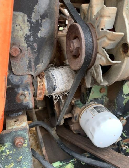

Picked up the A-37 / 4L390 fan belt mentioned earlier. (Took it back inside for them to recheck it as it didn't look right when I got to the car and sure enough they gave me the wrong one. So took care of that before we got home and discovered the ooops.)
The old belt had been on since --- oh, who knows when. (It may have been on the tractor when I bought it 7 or 8 years ago? Or maybe when we replaced the radiator we put a new one on??) Bolts were a bit of a bear to get loosened on the alternator. BUT ...
Feeling like total idiots here. :oops: We finally got the belt in and on and hubby (I am helping) is over on the other side and I'm looking at it going ... "That can't be right ..."
Do you have to drain the radiator and remove the lower hose so it fits inside the fan belt? The way I wrangled it on, the belt coming off the lower pulley lays across /ON the lower radiator hose on its way up to the alternator. As I said ... idiots up here. We had no pictures to go by, and the old belt was in shreds when I cut it off so I didn't think to look at how it went down below.
Help us, Obi Wans. :sick:
Thanks.
BBF

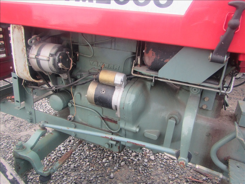

I'm in town right now so I can't see mine.
I looked for photos online. This was the only relevant one I found. Looks like the hose has to come off.
https://www.murphyauction.com/Content/Static/Auction/620/10170.14.JPG

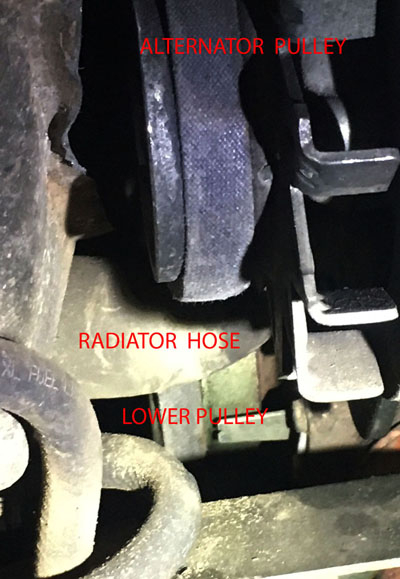

Here's what it looks like at this point .... It seems pretty obvious. (We are thinking to get a couple new radiator hoses as we go into the next stage and do some preventative maintenance while we are at it.)
I noticed in someone else's post on a different model that they had trouble with a new fan belt rubbing on their radiator hose. Sounded similar but he solved it by getting a slightly longer belt (Not where we are at.)
Maybe need to drop Aaron at Hoye a note?
Here's what I see ...

This hose is pretty ugly but should help see the routing. You will need to remove that lower hose.

I'm late here you have your answer. I have my tractor at my house but I 100% remembered when you said something about the hose. Yep you have to pop it off and back on. Grab you a clean bucket. Drain radiator (has an easy petcock) and then refill when done with same coolant. Or take this as an opportunity to change the coolant if needed. Which reminds me again. I need to change mine.
