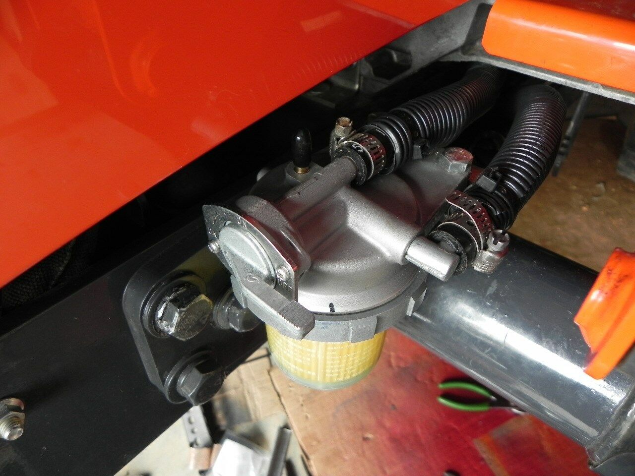

I don't know about you guys, but the more I learn about my Kubota BX2670, the more disappointed I am in the overall engineering and reliability. It looks like Kubota decided to use two cheap filters in the design and do not use a water separator. I realize I need to someday do the fuel/water separator mod, but that's a project for the future as I need to move snow ASAP.
Because my fuel filters are freezing up during cold weather, yesterday I attempted to replace them. The filter on the left side of the engine is easy to replace, but the one underneath is more difficult. In the design, Kubota decided to install the fuel filter underneath some kind of skid plate that's not removable so access to the filter is very difficult. To tell you the truth, I'm not sure I'm going to be able to change this filter. Has anyone else had issues getting access to the underneath fuel filter on their BX?

The BX I owned was bought 10 years ago but the skid plate could be unbolted on it. After that it wasn’t to hard. I added a Racor to mine, that helped and was mounted for easier maintaining. I had the Racor gel up once but at least you could see it through the fuel bowl. I also had the little factory one gel up on me twice.

Wouldn't an anti-gel additive prevent the gelling? IIRC, my 2009 BX2660 had only one fuel filter and the skid plate was a bolt on (4 bolts).

Filters don’t cause gelling, untreated fuel and cold temperatures do.

If your newer model is like the older ones the fuel line does not have a valve so you have to pinch the hose to change the filters. I extended the line and put in a valve. Then I moved the filter under the hood to underneath so both can be changed easily in one operation. Always planned to install a spin on but it keeps getting out prioritized. The one on the outlet of the booster pump should not plug up much. As var s I can tell it is to protect the injector pump.

Also add to that if a person is an infreq. users (ie: fuel sits for more than a few weeks in their machines and outdoors) but still insists on using untreated biodiesel in winter often are inviting problems in on themselves with geling, algae, etc..
Biodiesel in summer ok but never in winter for me.
Biodiesel can hold 10 - 20X as much moisture versus non biodisel
