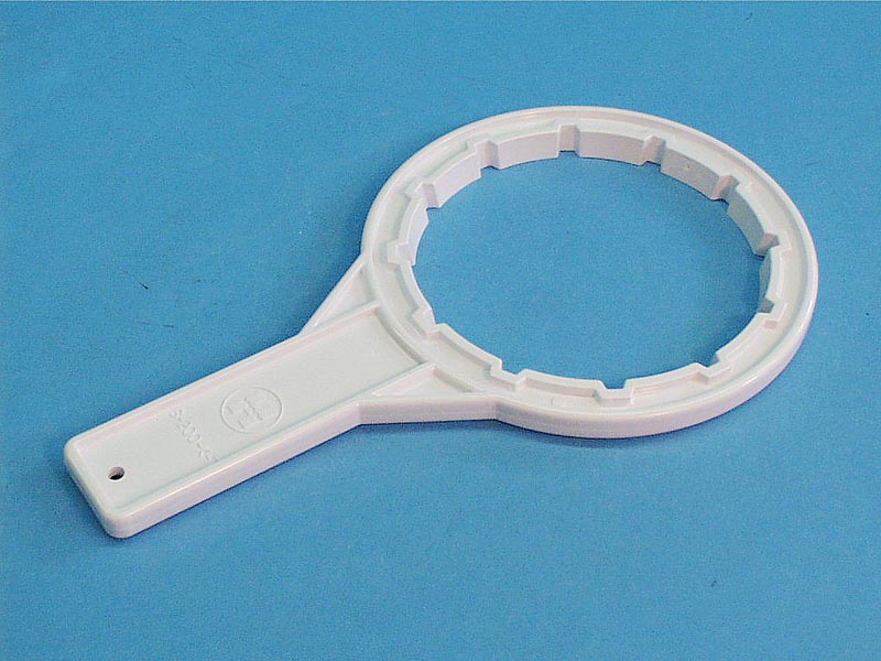

Don't know what a tooth spanner is -- is it something like the attached swimming pool filter wrench? If so, there is no room to get anything horizontal around the filter. The jawed vice grips I used had to come up from below the FEL mounting arm at a 45 degree up angle, catch a couple of the teeth on the fuel filter (not 180 across from each other), and turn only about 1/4" at a time until it was loose enough to turn by hand.
I'm too busy with remodeling and improvement projects right now to spend any time improving the tractor, but one of these days, Real Soon Now, I'll take a look at re-locating the fuel filter to a more accessible position. It's mounted on a sheet metal bracket that could be mounted anywhere. Does anyone know if there are any problems with the filter being mounted lower than the injectors?

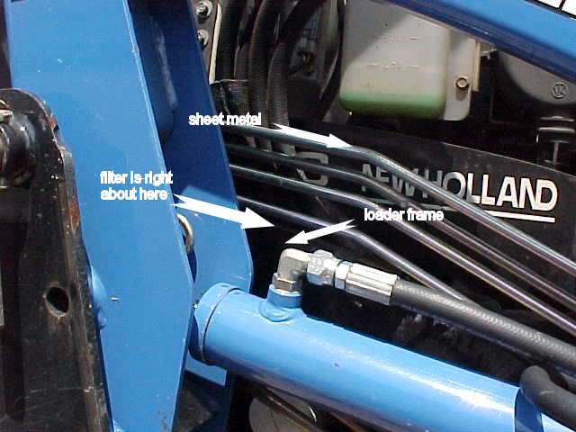

   / Changing TC24d Fuel Filter #13
I took some pictures. The first one is a little hard to see because of shadows. The space between the loader frame and the filter is about 3".

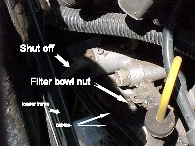

   / Changing TC24d Fuel Filter #14
The second shows the view from the outside -- if you had X-ray vision, you could see tbe filter behind the loader frame. The loader frame is the part that stays on the tractor, even after the loader is removed.

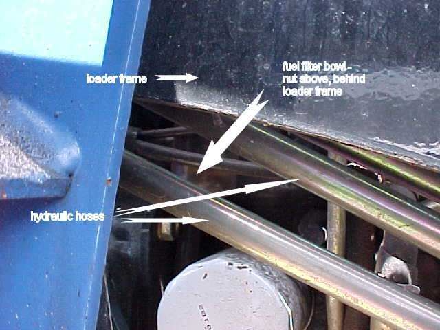

   / Changing TC24d Fuel Filter #15
The last one shows the view from below the loader frame -- the filter bowl is visible, but not the nut. The oil filter is also in the way, along with the labeled parts.
