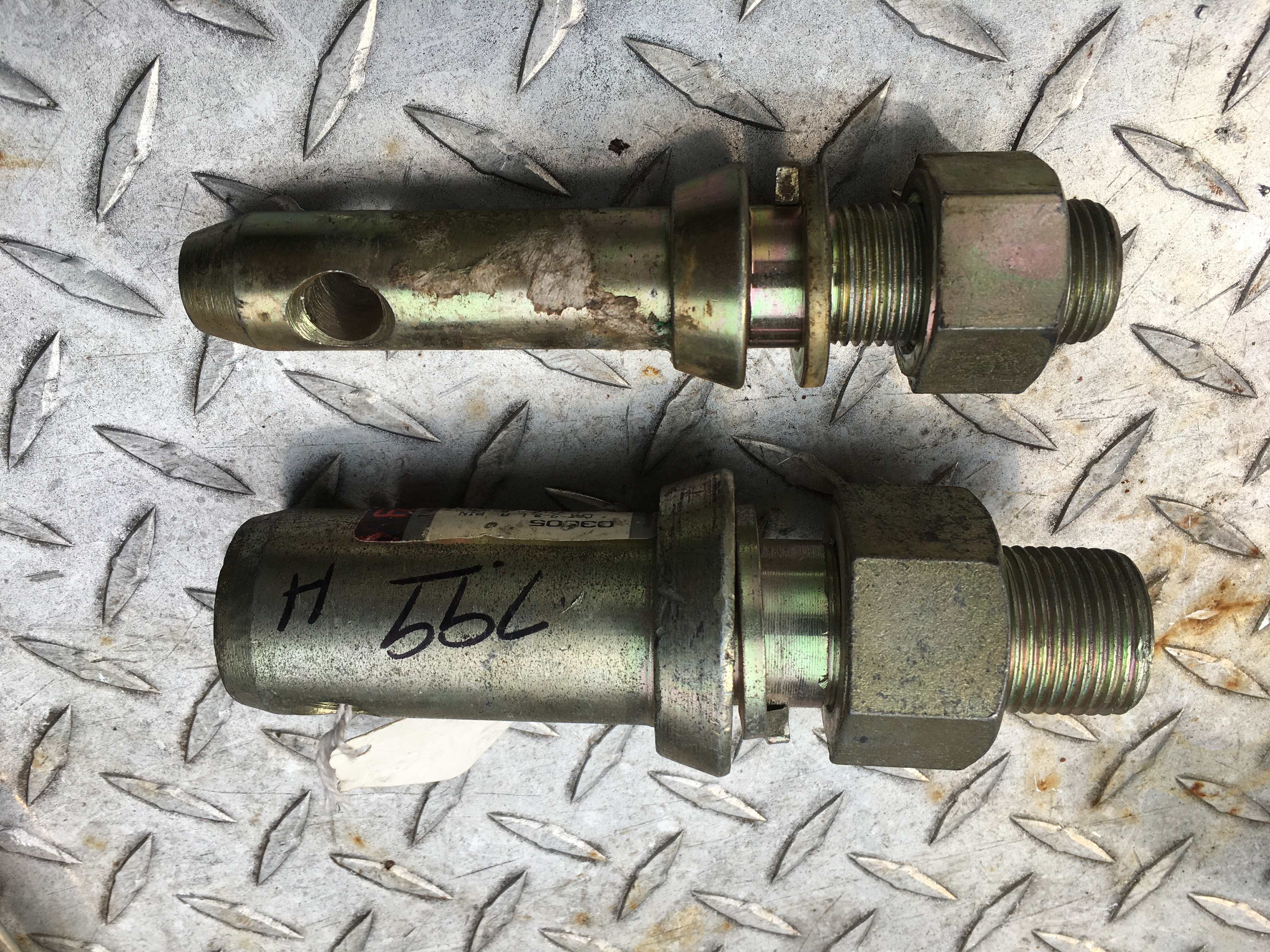

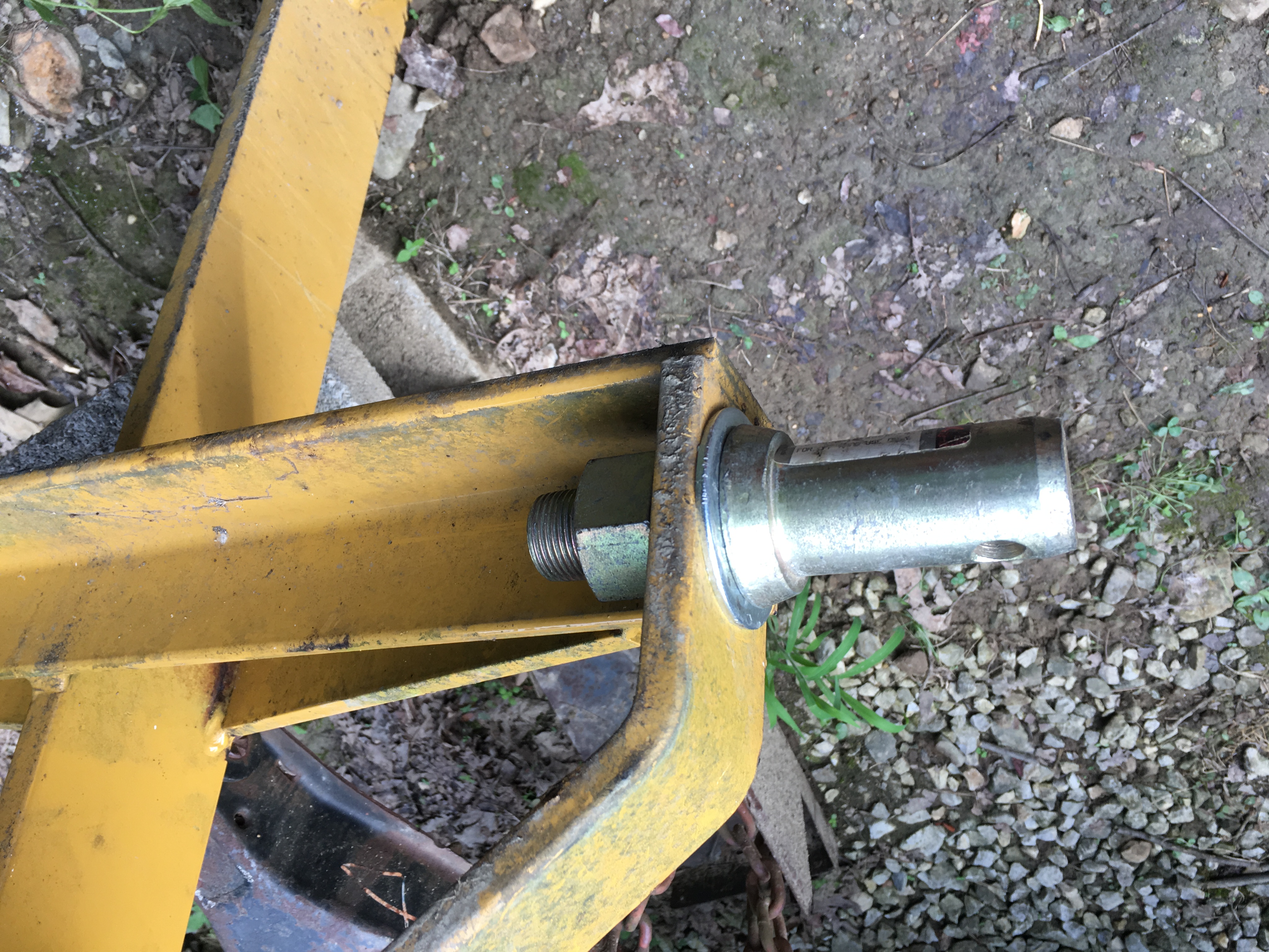

Found these cat 2 to 3 lift pins. Decided to try them after not being pleased with the bushings.

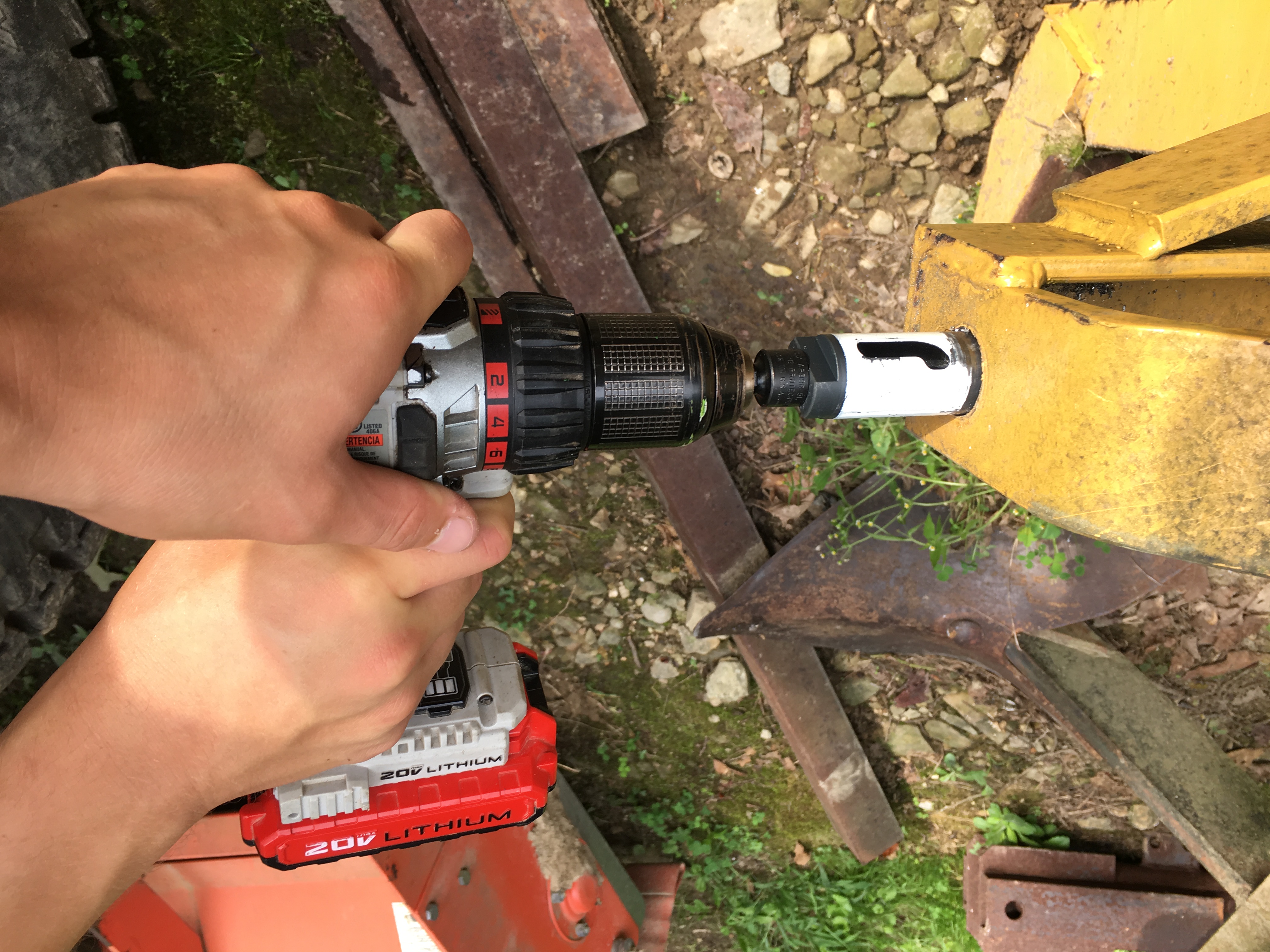

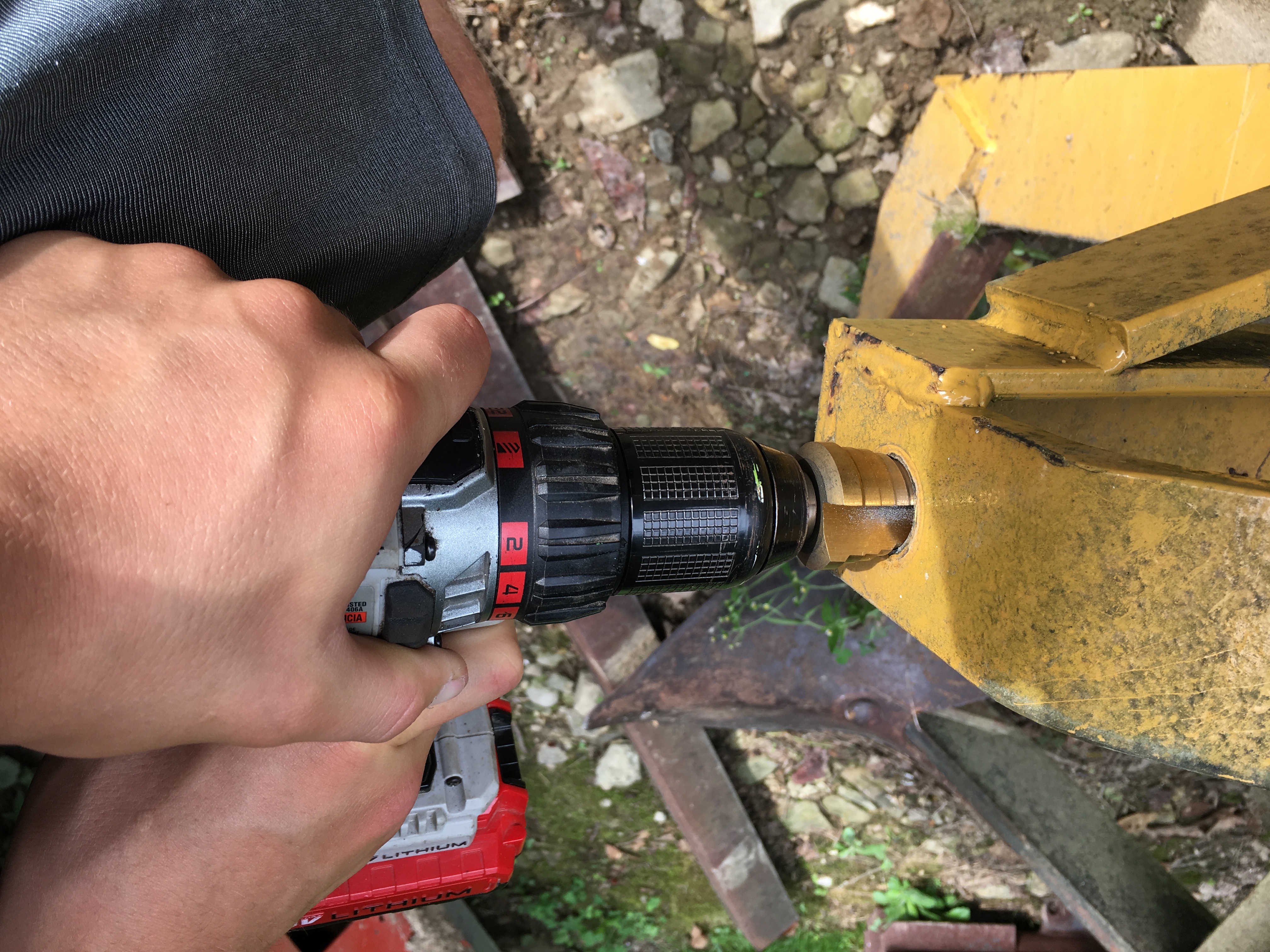

Fit my hitch perfect and a lot stronger. I had no 1 1/8 bit so my son used a HF stepped bit to start
hole a bit and finished it with a holesaw. Went quick I was surprised how good it worked. 0BC47B4C-AC40-438C-A48C-2E7F654F06B4.jpeg3A225385-BE57-46D8-83AC-90582C8B4EE3.jpegF5683E4A-E1E3-49B8-A64F-CD4671830304.jpeg0B5327B0-C3D0-4B01-9E13-41365CCD2F91.jpeg
