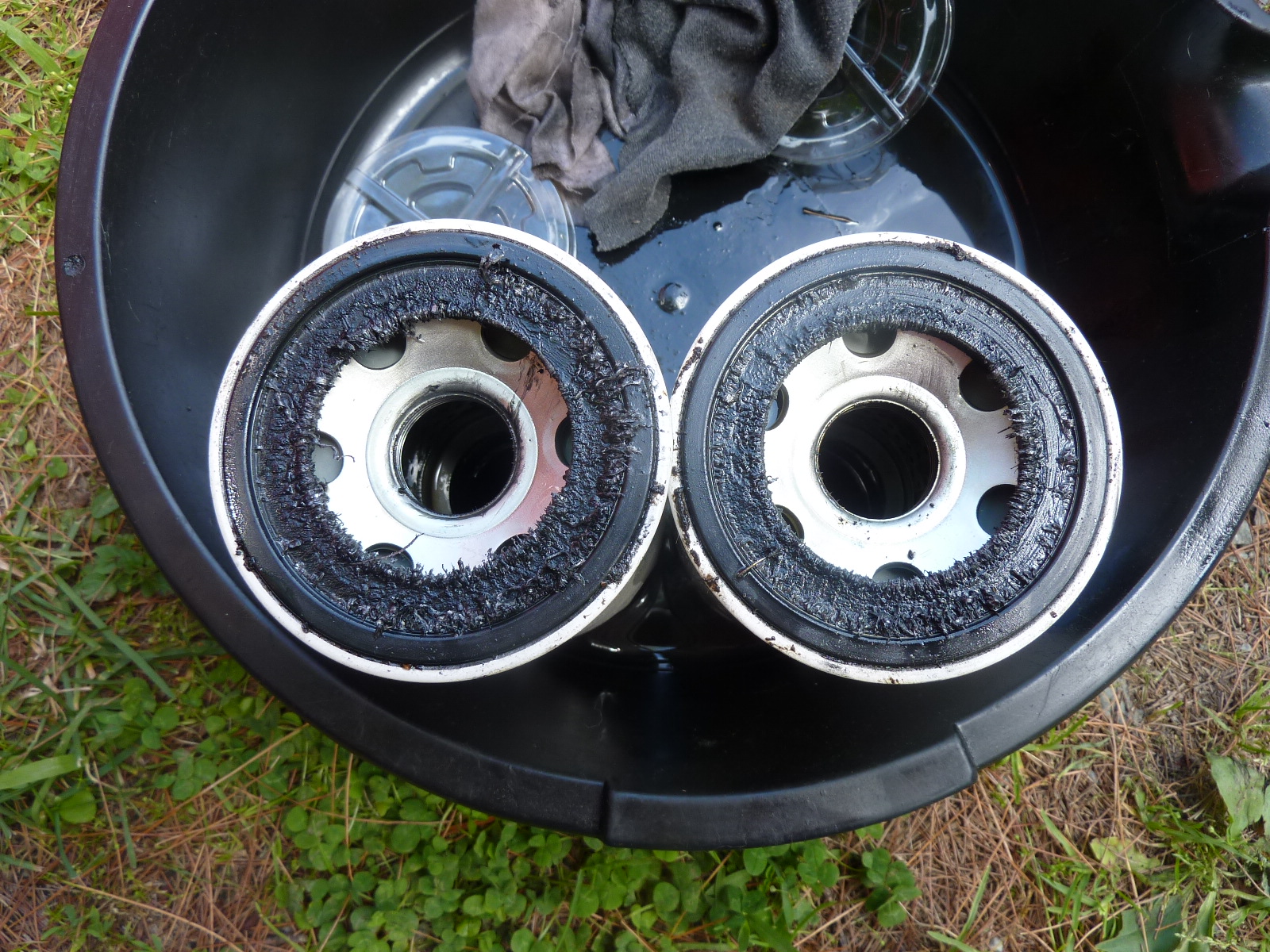

I like that odd shaped tin bucket, it looks homemade. Did you lay it out and break it?
Actually I found it in the woods :) Doesn't leak either. I guess someone either threw it away or used it doing some field maintenance and forgot it because he had more important things to worry about (been there).

I'm not sure I'm getting a clear picture of your situation.
So you're at it often enough for it to be routine?
Not sure what's going on there.
Might some shavings from the factory have gotten into the fluid circuit, and not actually indicate accelerated machinery suicide in your rig?
No doubt large-size particles can do great harm to engine tight tolerances.
But finer particles are not risk free.
Our submarines use centrifuges to remove such particles, which otherwise can remain suspended in the fluid.
It's YOUR coin-toss. Save some cash by not changing both filter & fluid. Or lose a bundle on expensive repairs due to having changed one, but not both.
Something else to consider:
You are right of course that physical solid foreign material is a danger to your equipment. But fluids reaching their life expectancy (no matter what the book says) is also risky. The obvious example, such fluids can develop corrosives which can accelerate wear.
You know the risks. 'tup to you.

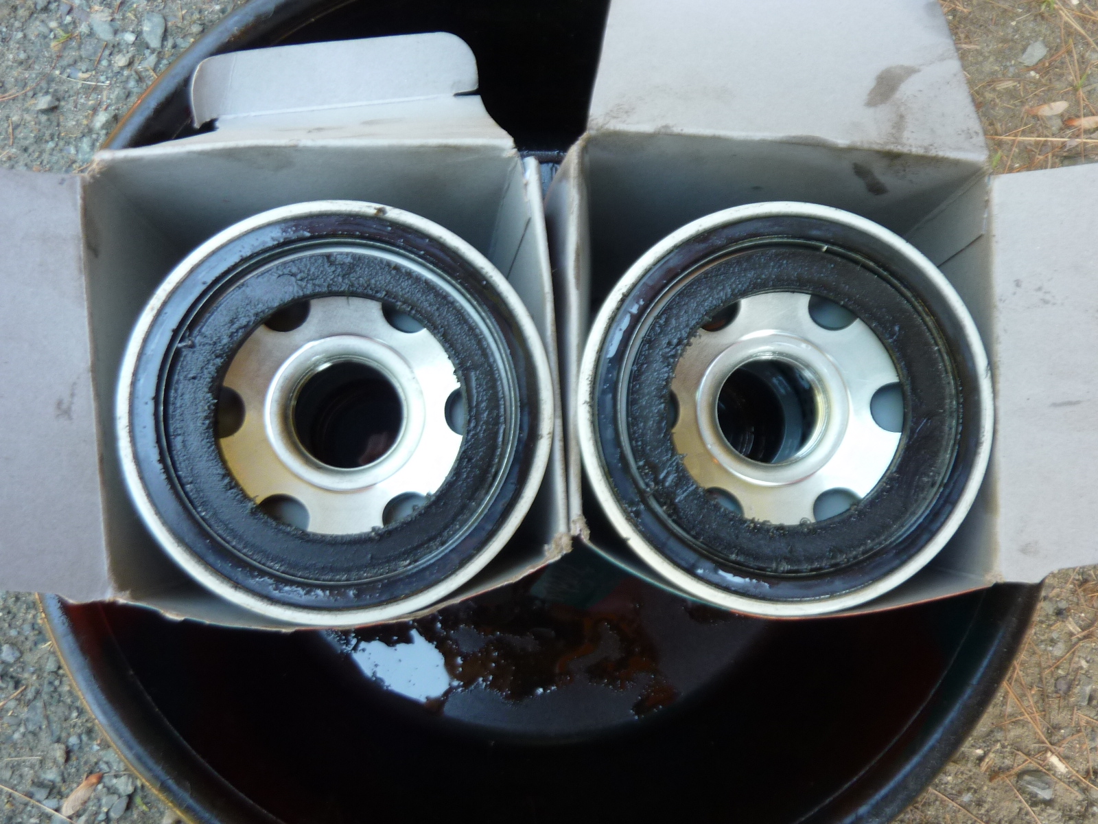

I am not worried about the crud on the filter being a sign of imminent failure. However, if I saw that 20 years ago I would be shocked at the shabby quality. Old standards die hard I guess. Over the resent past there has been some discussion about Kubota not cleaning the drillings etc from there transmissions and I just offered those pictures as two more examples of what filters look like now-a-days while doing routine scheduled maintenance. Might keep some one unaware from becoming very upset about their new tractor.

I would trust a n oil analysis by a reputable testing lab like Blackstone Labs more than what’s on the drain plug magnet.
Ferrous metal bits clinging to the magnet are likely machining dwarf not flushed in the cleaning process at the manufacturing plant.
Wear metals are microscopic, until catastrophic failure is imminent, or has already occurred.
I think most Diesel engine manufacturers eliminated the magnet on the plug. The magnet was scaring consumers.

On my M5640 I have to change the hydraulic filters ...
It is normal for newer Kubotas I guess but still disconcerting seeing this much crud on the filter magnets but it is way less this second change than it was the first filter change.
On a side note I have a gear drive transmission so I see no problem and have not had any issues using Rotella HD rather than Kubota Super UTD ?? even though I run my tractor all winter in below zero F weather.
gg
My Yanmar is a 1981. It too has very similar filters for the hydraulic system. I've pulled the filters and cleaned them. However, never have seen as much crud on them as yours shows. Almost 1/5th of that amount. Also, I re-used the fluid after filtering the fluid. The second time, I replaced the fluid. Still the filters were in good shape with little crud. Even the magnets only had a smooth gray slime of metallic deposits.
Your machine is a 2011 or newer. I'm a bit surprised at the amount of crud on the magnets! And the crud has a few metal fragments!
When changing the fluid, I learned to drain the fluid, have the filter out of the machine, fill the hydraulic system with diesel, work the tractor at low rpms, return and drain again. This will scrub out the metal fragments. Now, this can only be done when the loader and non-tractor hydraulic hose are connected. I've worked my machine at times on the hard side thinking, dang bet that wasn't good for the tractor! I'm amazed at how these good machines can take a few beatings. However, not so for a co-worker of mine with a BX series. He had to rebuild the engine.

So true. Usually in the owners manual, there is a first engine break-in period; X amount of run hours and change the fluids. This is to clean out the manufactures debris and the engine wear-in. Same thing goes for a rebuilt engine wear-in / break-in period.
After the mentioned above, the future filter changes should not be so drastic.
Looks to me like the reservoir to submerge an innertube into, to watch for bubbles. Service stations always had one.
Your probably right. When I found it I was suprized it wasn't full of bullet holes like most things like that you find in the woods around here. There are old milk cans and maple syrup buckets and even an arch and an old car all blasted to smitherines.
