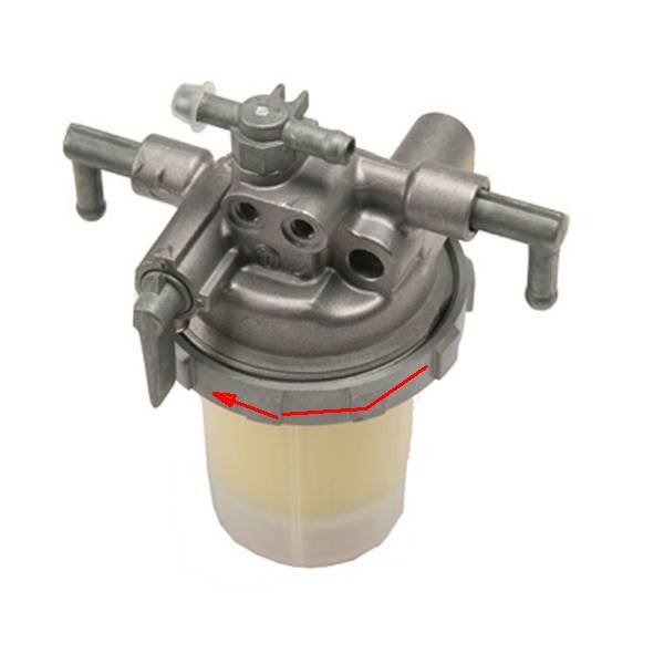

I'm trying to change the fuel filter (on engine) on my 1070. The manual says to remove the bowl, turn the top ring counter clockwise. Can't get it to budge. It looks to me like the ring should turn clockwise to remove it, but maybe I'm looking at it wrong. Sure dont want to break it.
Does anyone know from experience, when you're looking at the fuel filter assembly from the top, do you turn the ring clockwise or counter clockwise?
   / Changing fuel filter JD 1070 - can't move ring. #2
It is clockwise..
   / Changing fuel filter JD 1070 - can't move ring. #3
Turn it "off".. doesn't have reverse threads. Grab it and turn to the left.
Just a ring holding the bowl tight to the fixture above.
So if looking from the top, it would be clockwise. Looking up from the bottom, counter clockwise.
May have to get a large channel lock to get a hold of the ring to turn it.. have had to do that because it can be in a spot that is too close to get a good grip with the hands.

   / Changing fuel filter JD 1070 - can't move ring. #6
If you're looking at one of these, the ring turns towards the red arrow:
Thanks everyone. Exactly what I thought, but by trying to go by the manual I've now got it so tight it'll never come off.

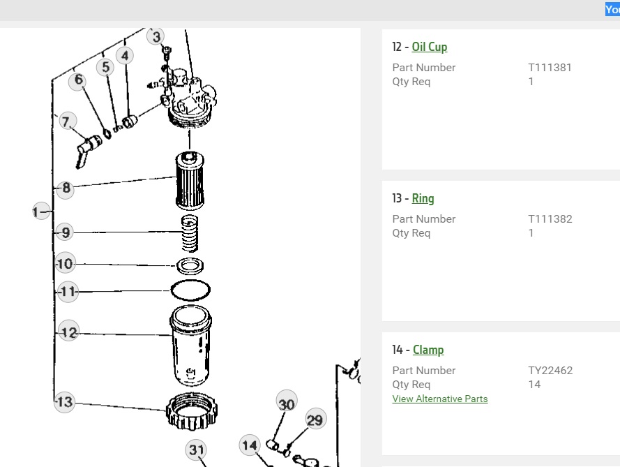

   / Changing fuel filter JD 1070 - can't move ring. #10
Part no. for just the ring (key #13) is T111382
