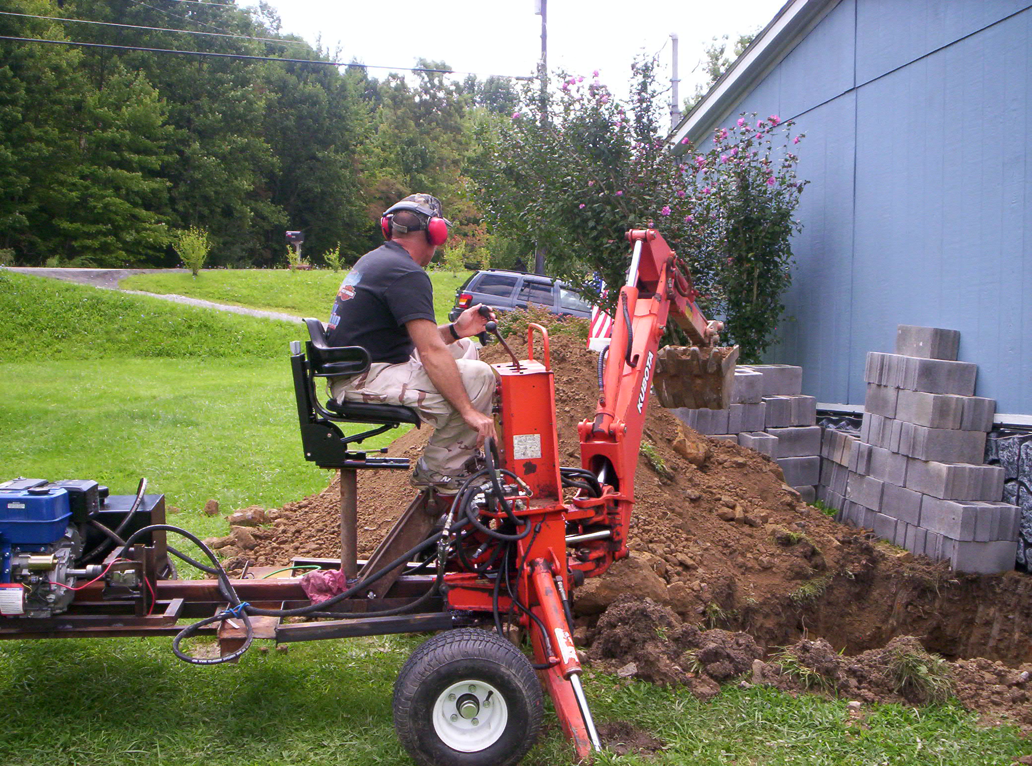

I have a frame mounted backhoe (jinma) on my Jinma 224.
I have 2 questions about it.
1. Is there an easy way to take the backhoe off of the tractor?
2. Does anyone have experience with putting a backhoe on wheels and tow it behind the tractor?
I have an old trailer with a 1-ton axle and I want to use this axle for the backhoe!
It would be nice to get as many ideas as possible!

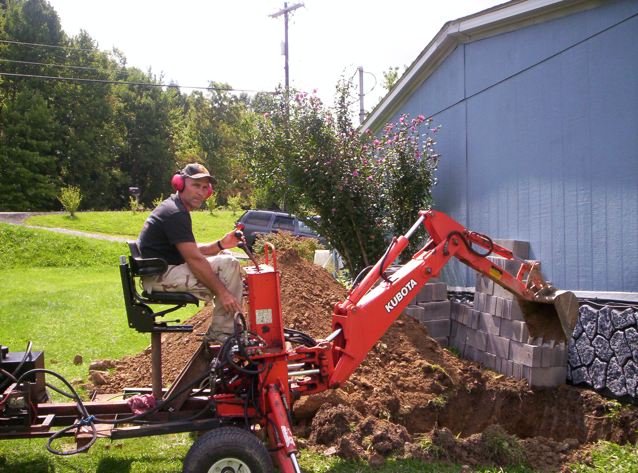

Something like this?
http://www.tractorbynet.com/forums/...update-im-making-progress-14.html#post2485284

Unless you intend to have a lot of weight added to your trailer mount, say 800 lbs. to 1,000 lbs., I don't think you'll be very satisfied with the performance.
You will have very little down pressure due to the weight limitation, so at best all you will be able to do is scrape and curl the bucket. If and when you do this project be sure to install and wear a seat belt. You'll find out why.
Also, if there are springs on that old 1-ton axle trailer I suggest removing them - this has to do with the seat belt recommendation.
Note in the Kubota pics that there are no axle springs. Also note how far the outrigger pads are buried in the soil. That setup bounces a lot.
Good luck.
