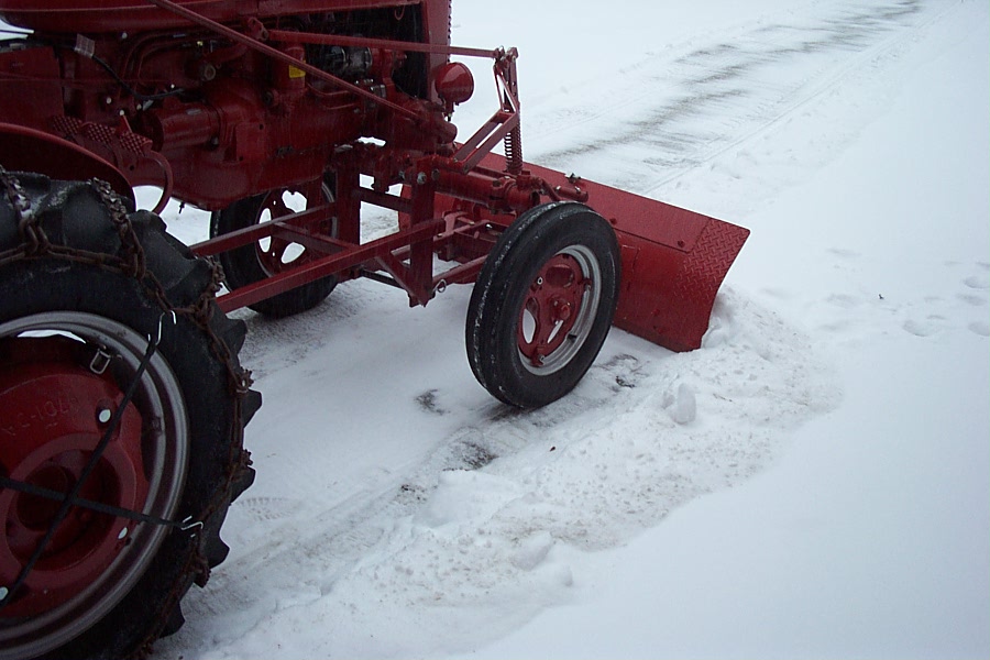

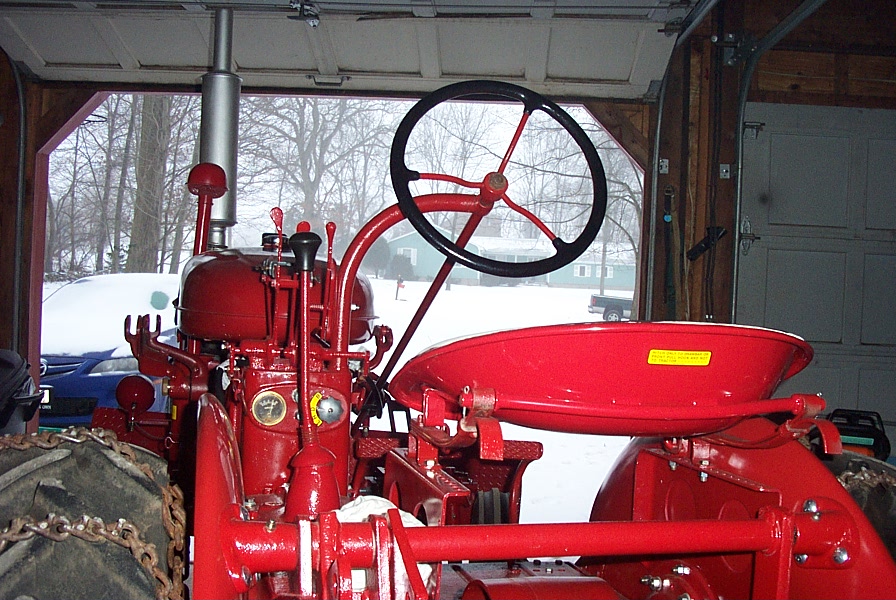

I certainly dont want to discourage you if your lookin to convert to 12 v but I have a 42 Farmall A and a 49 Farmall Super A that are both still 6 volts and they start in the coldest of weather. I use 20 wt oil and they are both in perfect tune and they will start ! I still use the 49 to plow snow !
