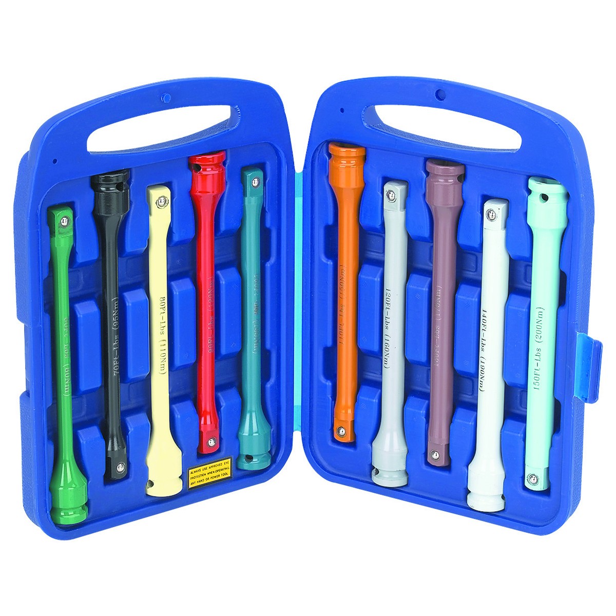

I use my engine hoist to raise, impact off and impact on using a torque stick extension. They are a 8' long extension made out of spring steel, available in different torques, made for lugnut, they flex when torque value is reached.
Dave
