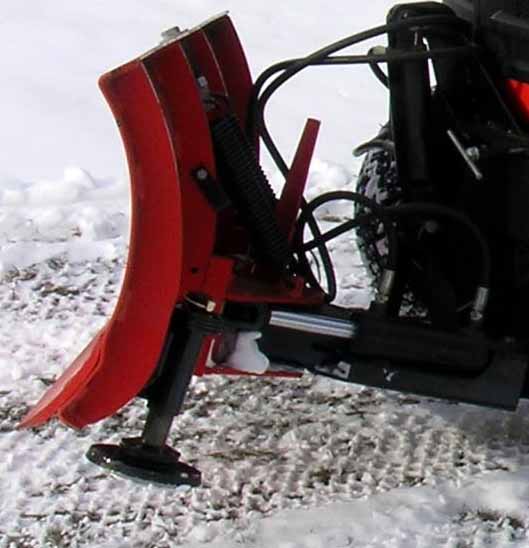

I'm happy to hear that I'm not the only one who has to do multiple backups to get it lined up right /forums/images/graemlins/grin.gif. If I lift the front blade and angle it all the way it's easy to drop the shoe off from that side to adjust the shims, then angle it the other way for the other side. see attached pic.
