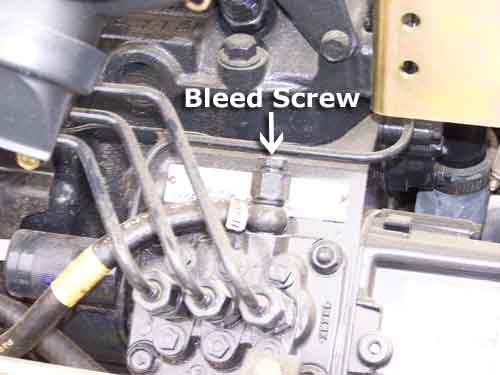

On mine there's a bleeder screw to the right and down from the air filter and slightly above and to the right of the fuel filter. Here's what the TC25's looks like. My TC45 looks similar.
I just changed my fuel filter and bled mine there - it was (IIRC) an 11mm that fit it. Could be different on yours. I opened that and it bubbled a bit and then flowed without bubbles. I did that again after starting it for a minute or so. Shut it off and bled it again and a few more bubbles. I suspect someone with a lot more experience than I have will know more on this but it worked for me.
Hope that is helpful,
Matt

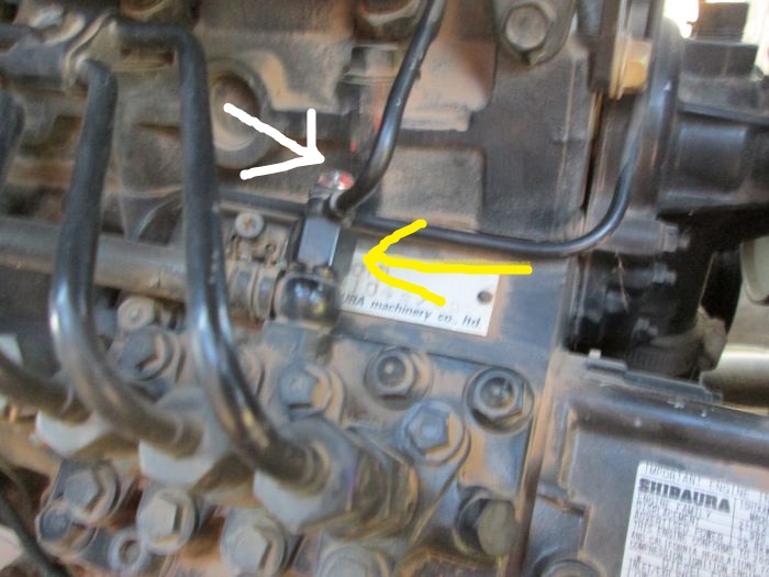

In this photo, which is the bleed screw? Yellow or white arrow or neither? If it's the white arrow, it looks difficult to get a wrench on it. Any special tools needed? Maybe a universal socket? What size socket do I need? I can't get any of my sockets on it-I have limited mm sockets and plenty of sae sockets but nothing seems to fit. If it is the yellow arrow it takes an 11/16" open end wrench which I have.

I would crack the white one and try it...

If you have the fuel filter full and loosen one injector line on the injector and crank it over if should force the air out and start..
